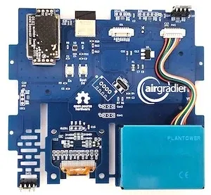

AirGradient ONE Indoor Monitor
Version Image of PCB / Files Main Improvements / Changes Link to Instructions Arduino Sketch Name
I-9PSL Model v9 assembled small mm4hrede 87x7d5zb
black or blue PCB
KiCad files main PCB
Gerber file main PCB
KiCad files LED bar
Gerber files LED bar
SGP41 Module
SHT40 Module
Enclosure STL
Clip-On Stand STL
Complete new design. ESP32-C3-Mini, RGB LED bar, hardware watchdog Build instructions OneOpenAir.ino

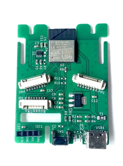

AirGradient Open Air Outdoor Monitor
Version Image of PCB / Files Link to Instructions Arduino Sketch Name
O-1PST Model oa board front 90 mm4hrejp z8nj08mv
KiCad files
SGP41 Module
CO2 Module
STL Files

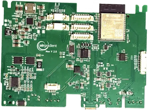

AirGradient Open Air Max Professional Outdoor Monitor
Version Image of PCB / Files Link to Instructions Firmware Code
O-M-1PPST-CE-S Model max pcb mm4hrer7 almrvg2c
KiCad file main board
KiCad file cellular card
SGP41 Module
SHT40 Module
CO2 Module
STL Files
N/A. Only available fully assembled openair-max repository

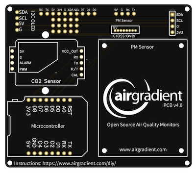

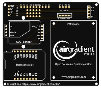

DIY Basic 4.0 basic v4 mm4hrezj mmx94bl2
Gerber files
STL Files
Switched to shorter cross-over cable for PM. Made T/RH sensor slot compatible with AG module Standard version BASIC.ino

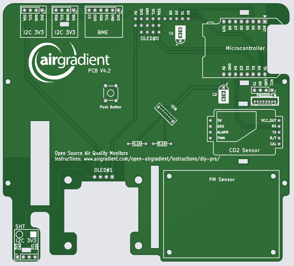

4.2 pro v4
black or green PCB
Gerber files
KiCad files
Enclosure STL
Clip-On Stand STL
Improved tracing / ground plane, removed D1 shield, changed button connection, switched to cross-over cable for PMS Standard version / Presoldered version DiyProIndoorV4_2.ino

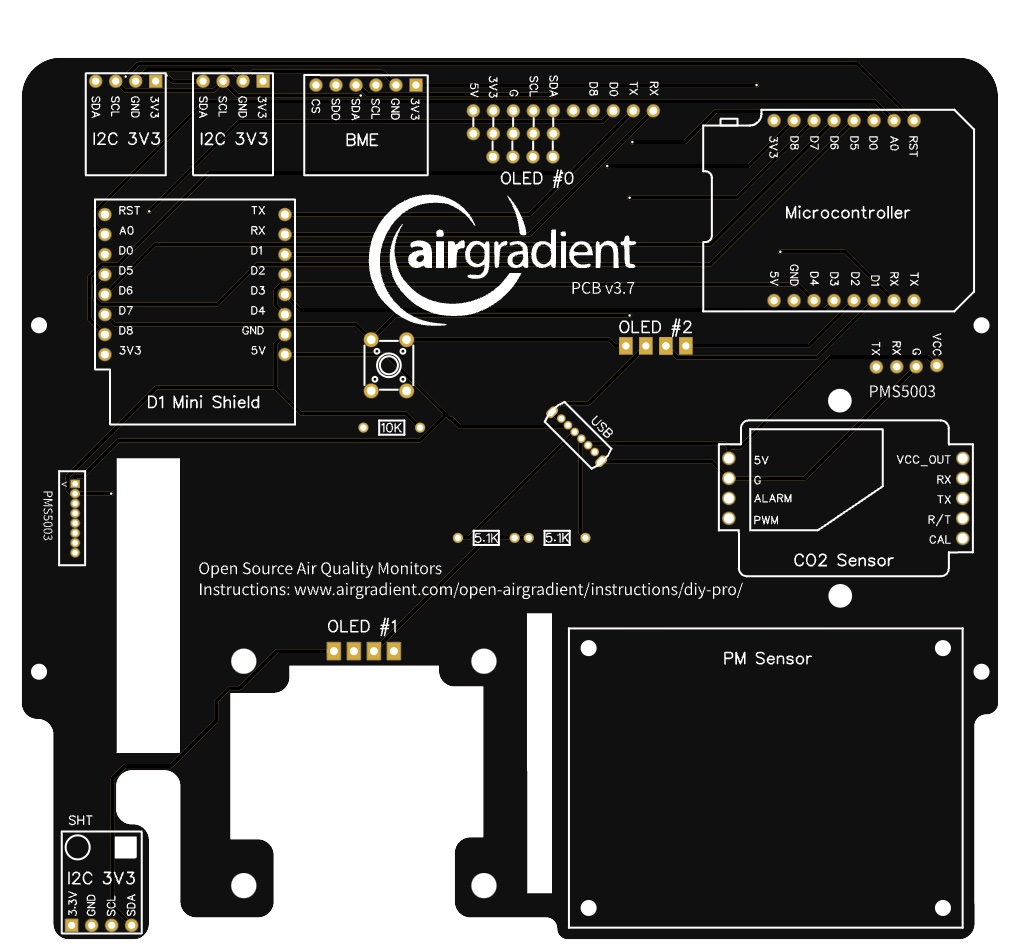

DIY Pro 3.7 pro v3
black or green PCB
Gerber files
Enclosure STL
Clip-On Stand STL
Push button for configuration, rounded corners Standard version / Presoldered version Compatible with DiyProIndoorV3_3.ino (no push button functionality)

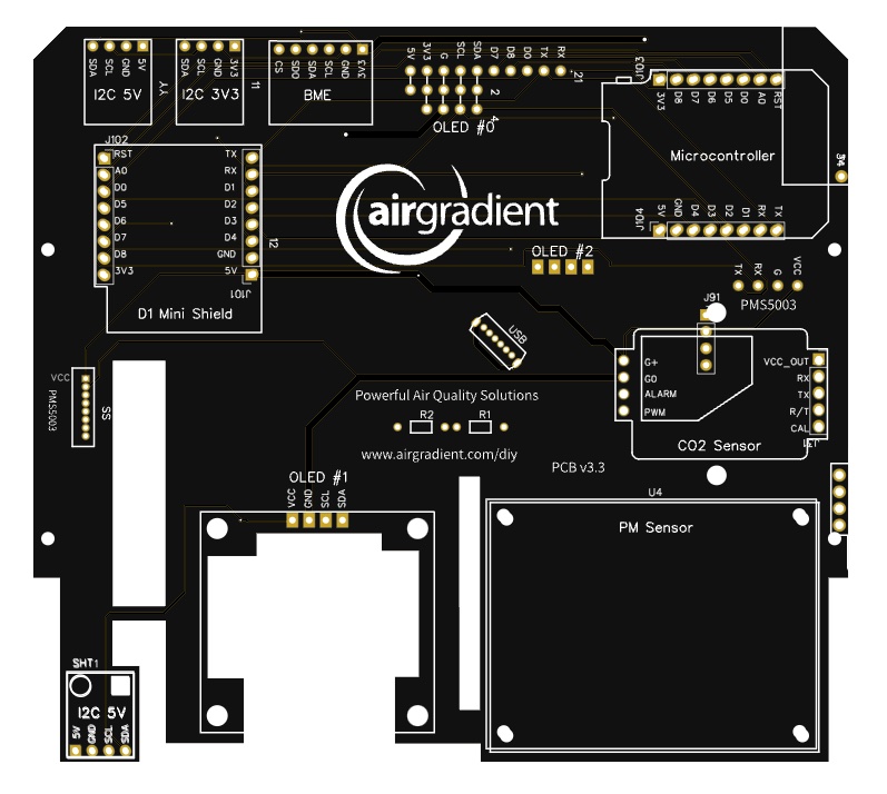

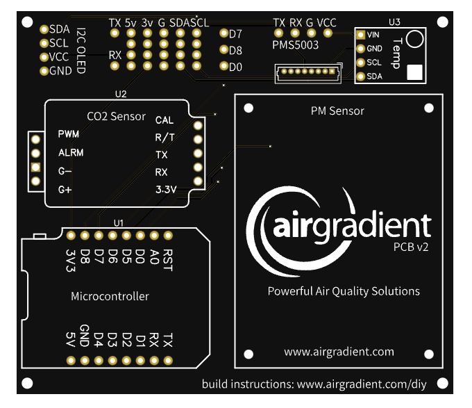

DIY Pro 3.3 v33 pcb mm4hrfmf ravzrkn0
black or green PCB
Gerber files
Enclosure STL
Clip-On Stand STL
Standard version / Presoldered version DiyProIndoorV3_3.ino
