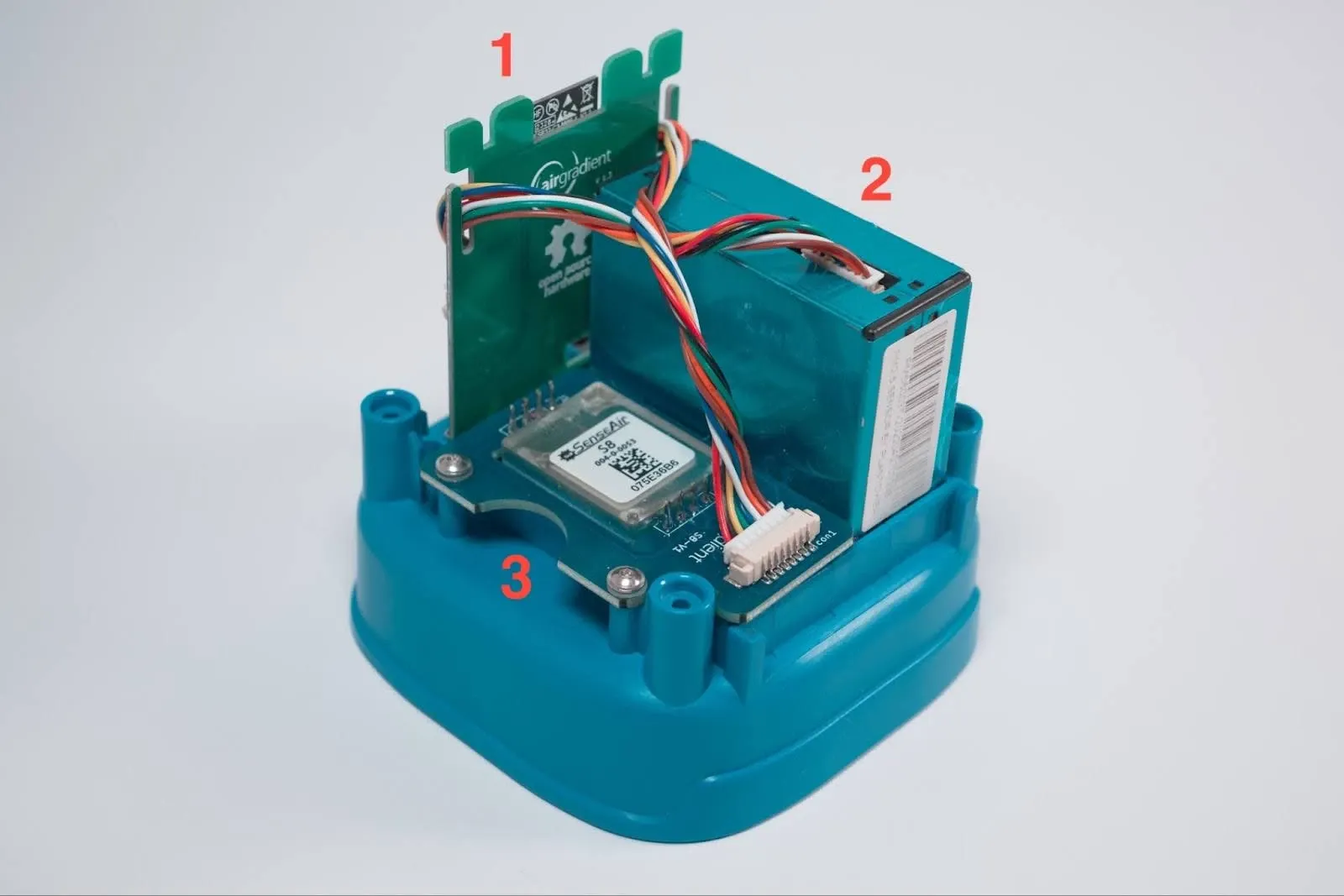

5. Replacing Components
Nearly every component in the AirGradient Open Air can be individually replaced. Here are the components:
  1. Mainboard (the main PCB (Printed Circuit Board) of the device with the USB port and connectors to the sensors).
  2. PMS5003T particulate matter sensor (a large, blue box that is connected to the mainboard). This is the most likely component to need replacement as it has moving parts (a fan) inside.
  3. SenseAir S8 CO2 sensor (a sensor that sits next to the PMS5003T and is mounted on its own board. It is connected to the mainboard via a ribbon cable).
  4. SGP40 VOC sensor (a small sensor that sits next to the USB port of the device).
Please refer to the images below for information on the placement of each component. Each of these can be purchased separately on the AirGradient store.

Components of the Open Air Monitor are numbered in the text above.
Components of the Open Air Monitor as numbered in the text above: Position of the VOC sensor (number 4).
