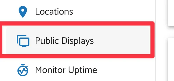

5.1. Open Public Displays
  1. Open the AirGradient Dashboard.
  2. Click the show sidebar icon in the top-left corner.
  3. Select Public Displays.
Public Displays in the AirGradient Dashboard sidebar
If Public Displays is not available, ask your Dashboard administrator to check your permissions.

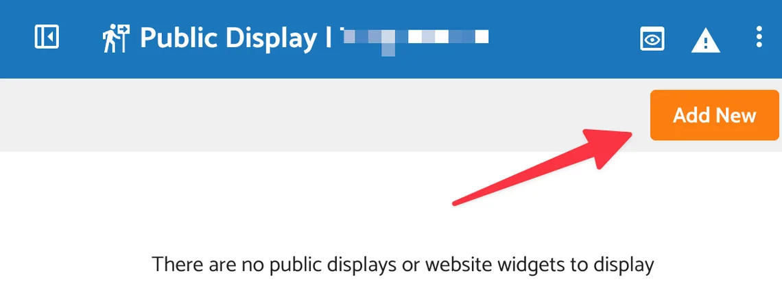

5.2. Create a Display
  • Select Add New.

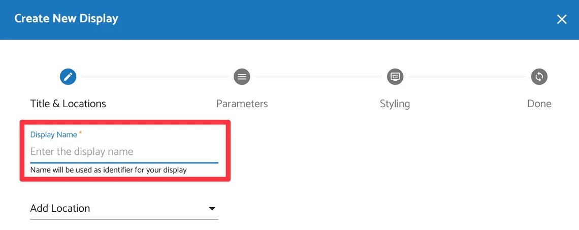

  • Enter a name for the display. This name is used to identify the display in your Dashboard and is not shown on the public display.
Naming a public display

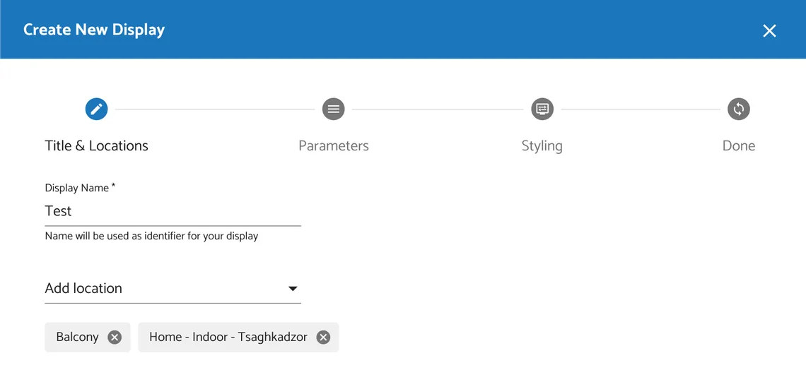

  • Select one or more Locations to include. Depending on your Dashboard setup, you may also be able to include averages for indoor or outdoor Locations.
Selecting locations for a public display
  • Select Create.

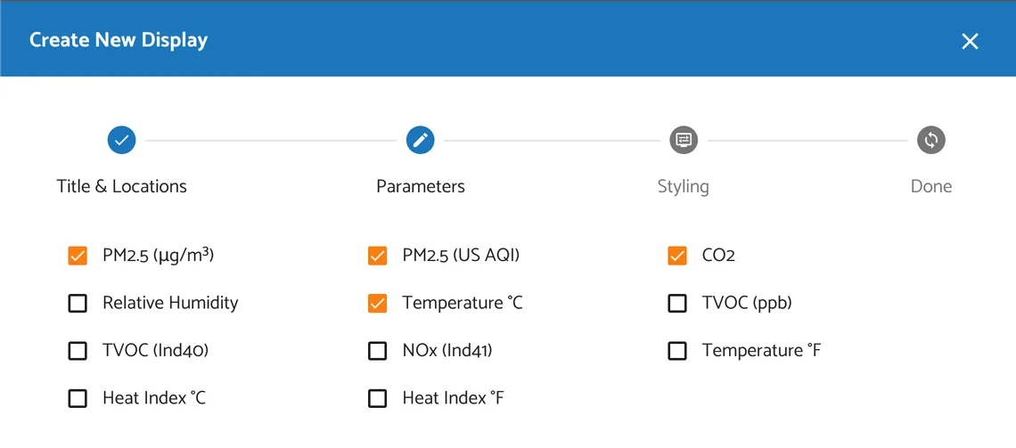

    5.3. Select the Measurements
Choose the air quality measurements you want to show, such as PM2.5, CO2, temperature, or humidity. The available measurements depend on the monitor model and Locations selected.
Selecting measurements for a public display
For a public display, include only the measurements your audience needs so the information remains easy to read.
