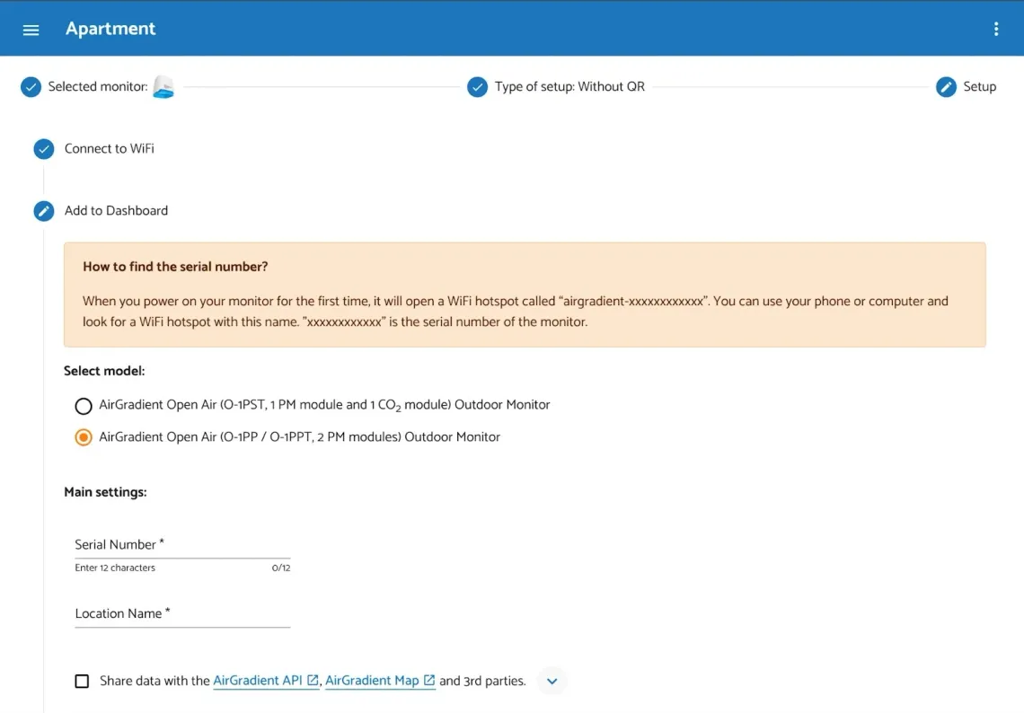

When setting up a new AirGradient Open Air monitor, go to the onboarding page: (https://app.airgradient.com/onboarding/welcome):

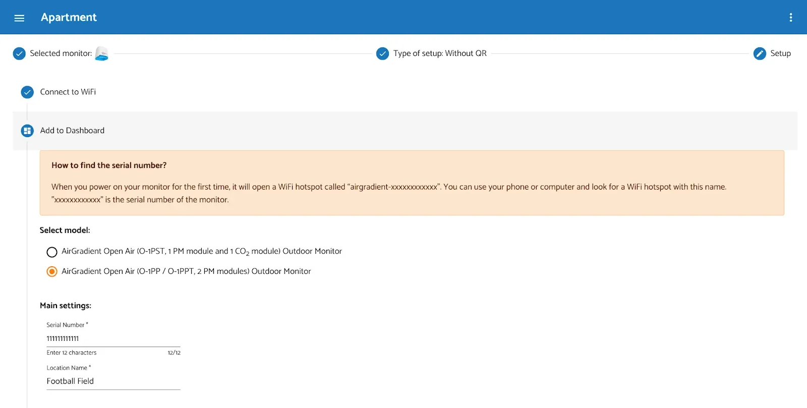

- Serial Number Entry:
- Choose the type of monitor model and configure the main settings.
- Select Model and Main Settings:
- Enter the unique 12-character serial number found on the back of your device, or shown when connected to Wi-Fi.
- Data Sharing Options:
- Just as in the Dashboard view, you will see the options to share data with AirGradient API, Map, and OpenAQ.
- Enter the location coordinates and contributor name (optional). The contributor name will then appear on the AirGradient map and also on the API.

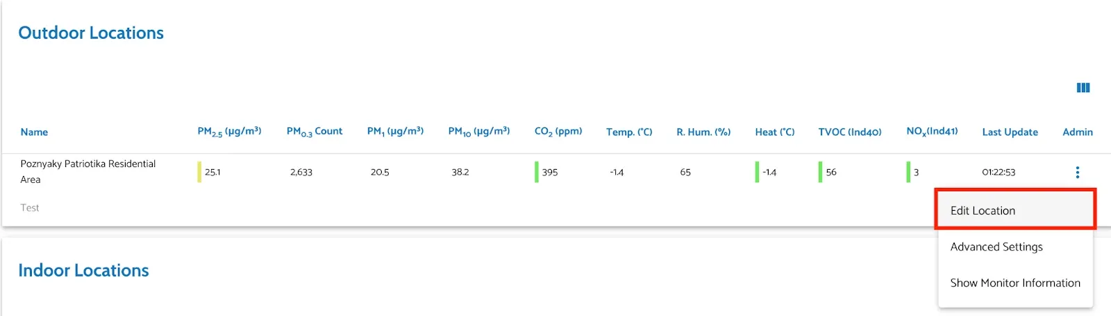

If you have decided to share your data at a later stage, you can do so at any time. Go to the ‘Dashboard’ (https://app.airgradient.com/dashboard) page and follow the next steps:
Go to Edit Location
- Find the desired location on your Dashboard in the table of Outdoor Locations.
- Click on Edit Location
Figure 5: Edit Location menu item in location’s actions column - Go to the Data Sharing tab

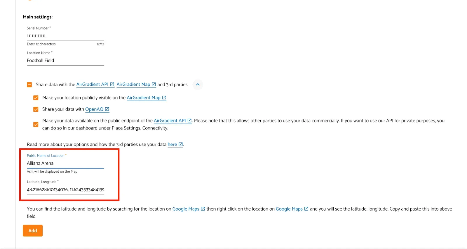

Choose Sharing Options:
- You will find checkboxes for sharing your data with:

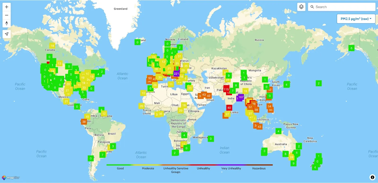

- AirGradient Map - a real-time, global map that displays air quality data, primarily sourced from open-source AirGradient monitors.
- OpenAQ - a global repository of air quality data used by many organizations and research institutions. AirGradient is an official partner of OpenAQ and strongly supports their mission, as well as share the same ethos around open data. By sharing data to OpenAQ,
- AirGradient API - allows access to air quality data from their open-source, open-hardware monitors, enabling users to integrate this data into other systems or applications.
Figure 7: Sharing options on ‘Data Sharing’ tab - You will find checkboxes for sharing your data with:
Enter Location Information:

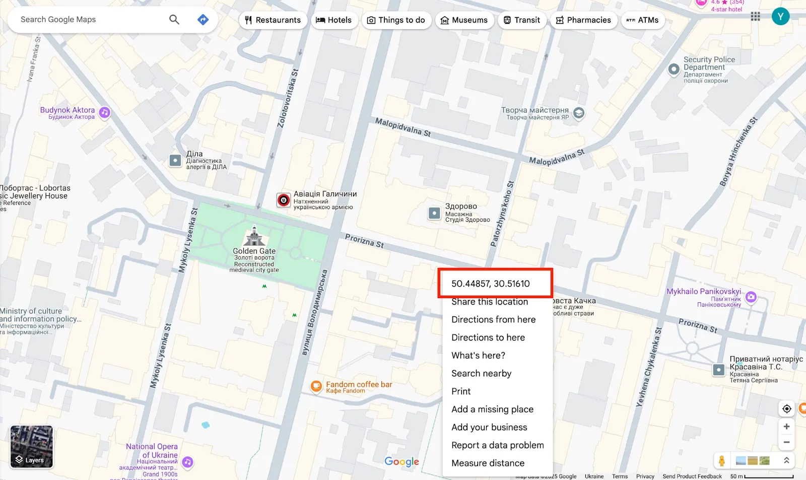

- Latitude & Longitude: You can copy your monitor’s coordinates from Google Maps.
- Location Name: Give a recognizable name to your monitor’s location.
- Public Contributor Name (optional): Add a name if you wish to be credited.
Figure 8: Filled up form on ‘Data Sharing’ tab

You can access the map by going to this link: https://www.airgradient.com/map/

How can I get coordinates?
You can find the latitude and longitude by searching for the location on Google Maps then right click on the location on Google Maps and you will see the latitude, longitude. Copy (by right click on it) and paste this into the Longitude, Latitude field.
