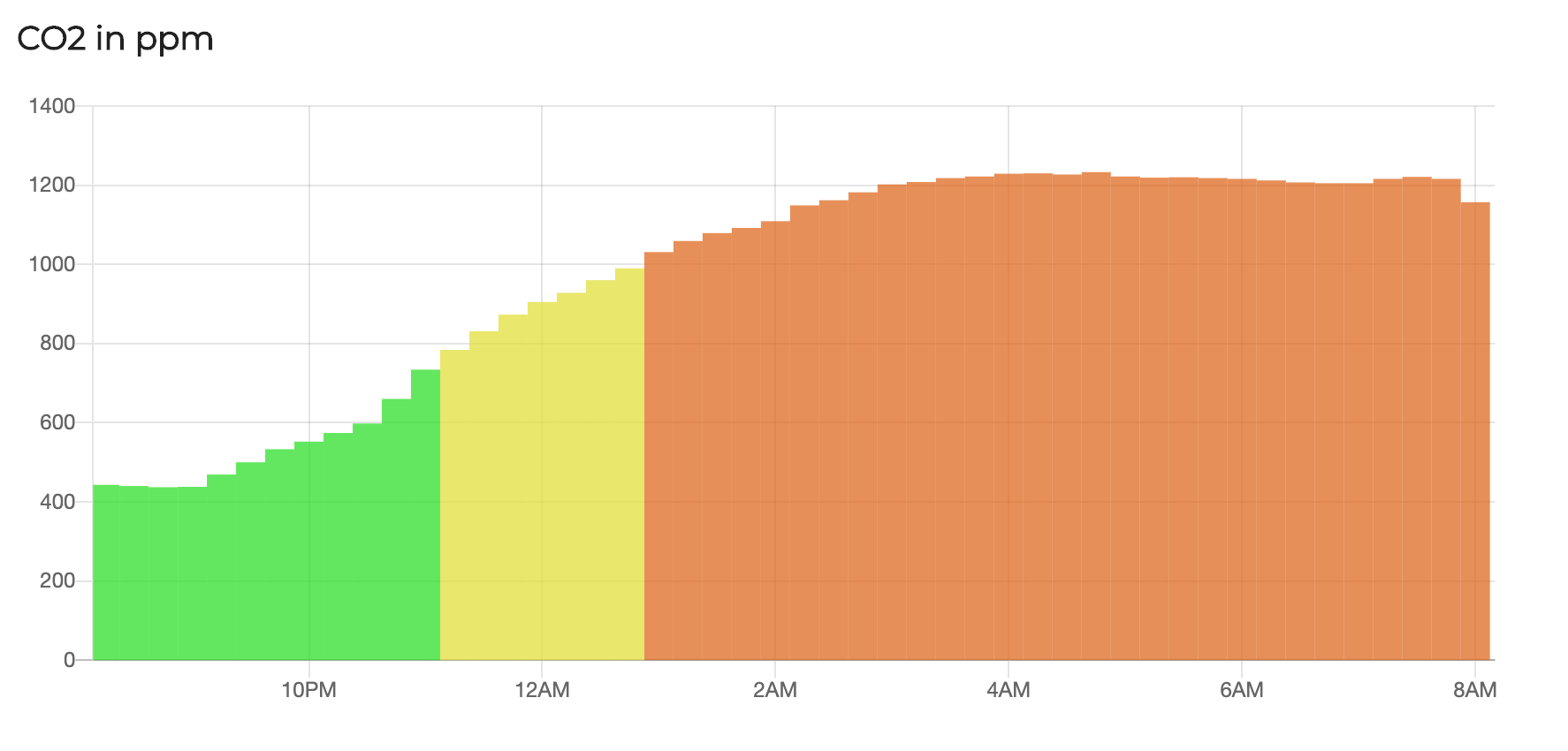

Closed Bedroom, No PPS, two persons
This is what we see in most bedrooms if your bedroom does not have a ventilation system and you keep the windows closed.
image5 mmta68pf t0cchfe2
You can see that CO2 levels increase quite substantially throughout the night and hover around 1200ppm.

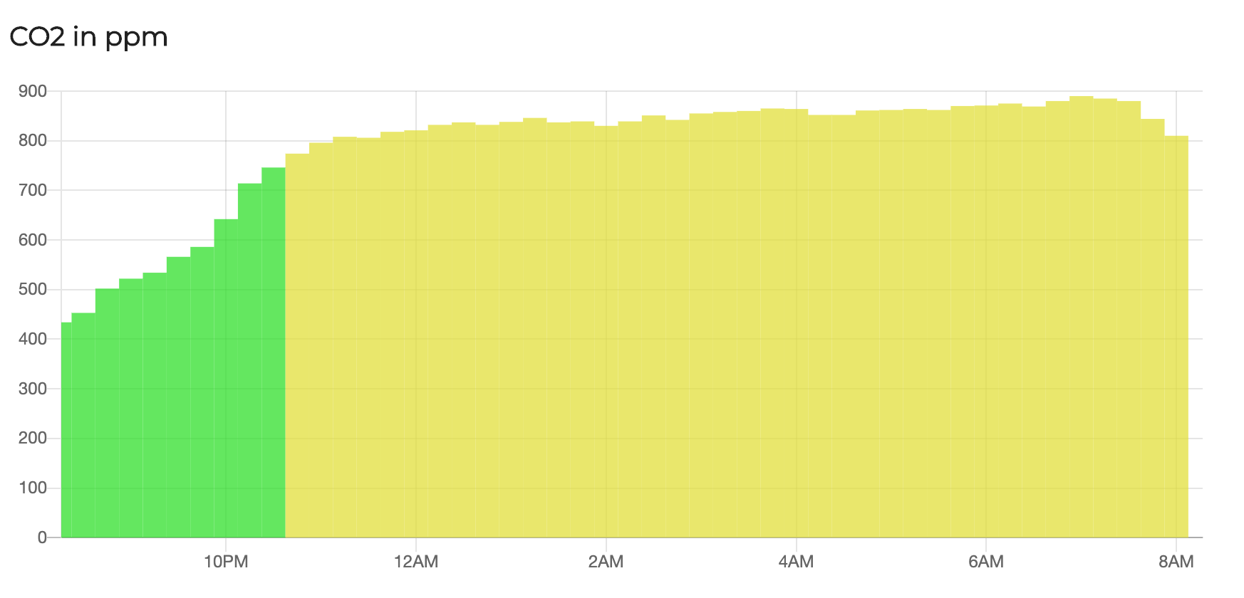

PPS in one Bedroom, two persons
Now if we run a small positive pressure system in the same bedroom with two people sleeping, we can observe considerably lower CO2 levels below 900ppm.
image 33 mmta68xo czc9ocjf

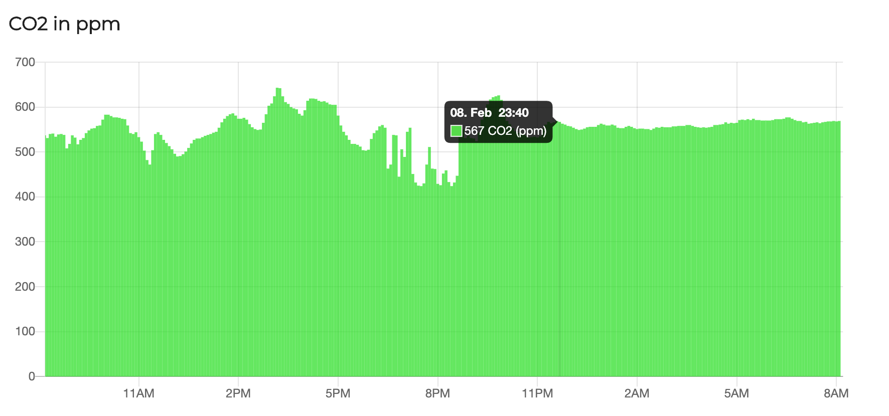

PPS in one bedroom, one person
The below chart is from a kid’s bedroom with a PPS. As you can see, the CO2 levels are excellent due to a child producing less CO2 and also only one person being in the room.
image 15 mmta699x sowivp43
The PPS system keeps the CO2 levels in the bedroom consistently below 600ppm.

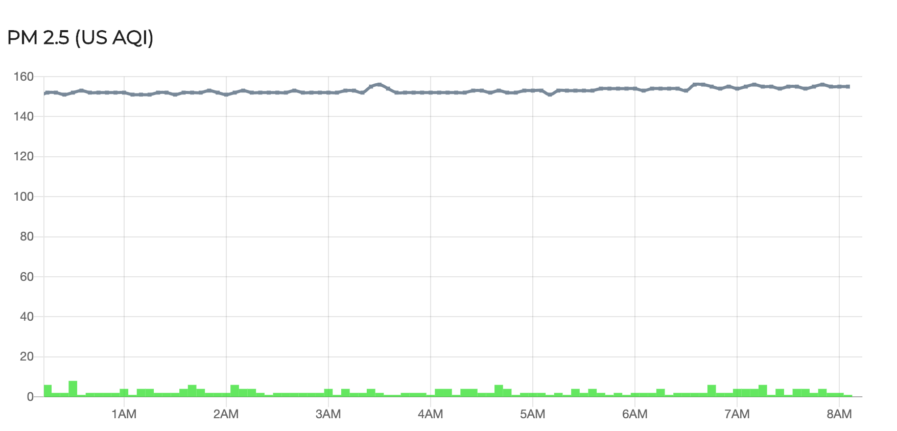

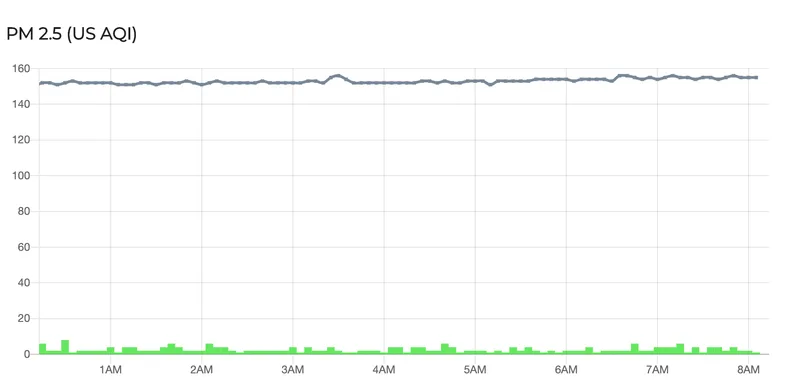

Let’s have a quick look at the PM 2.5 levels in the same room. As you can see, the particles inside the room stay at extremely low levels as the positive pressure system prevents polluted air from entering.
image 24 mmta69hu mjlagvhg

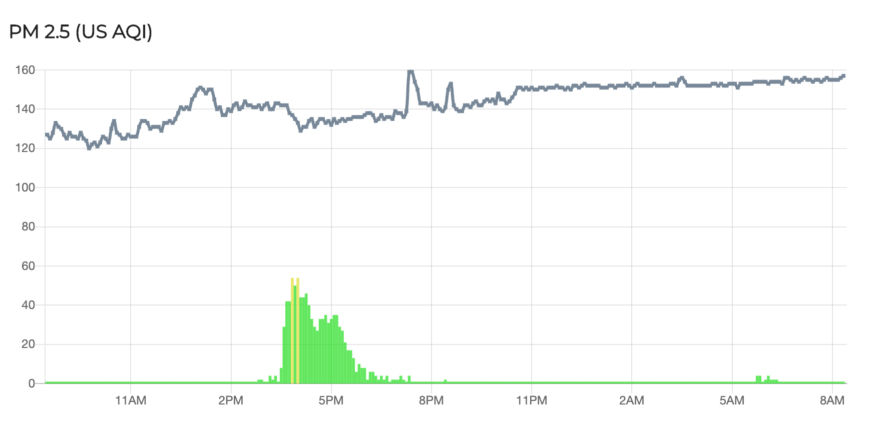

Effect of sealing of Rooms
In the above PM 2.5 chart, you can still detect a very small amount of pollution in a room. If you ensure that your bedroom is additionally sealed, you can actually achieve a flat-line. Below shows another very well sealed bedroom.
image 40 mmta69pm ondkrdp6
The spike at around 5 pm was the result of having a window open. Other than that you can see that the pollution in the room was most of the time Zero.
