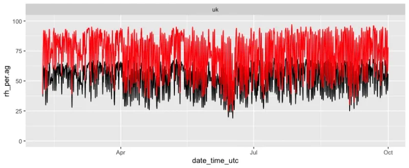

Time Series Plot
ggplot(data_all, aes(x=date_time_utc)) +
  ylim(0, 100) +
  geom_line(aes(y = rh_per.ag), color="black") +
  geom_line(aes(y = rh_per.ref), color="red")
uk raw mmtada2b 92ljekju

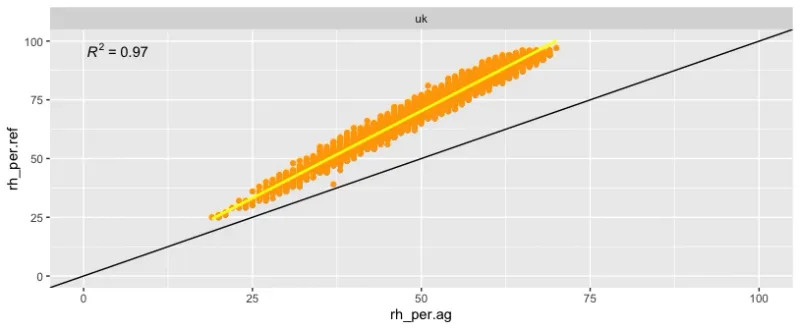

x/y Plot
ggplot(data_all, aes(x=rh_per.ag, y=rh_per.ref)) +
  geom_point(colour = "orange") +
  geom_smooth(method = "lm", se = FALSE, colour = "yellow") +
  geom_abline() +
  stat_poly_eq() +
  xlim(0, 100) +
  ylim(0, 100)
uk raw xy mmtada61 1u9tzt6n
