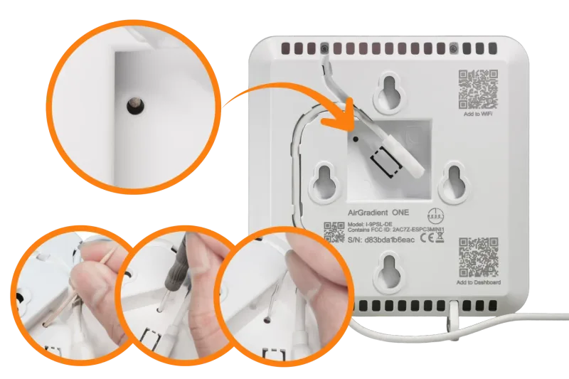

  1. Locate the BOOT button
On the back of the monitor, next to the USB connector, there is a small hole.Inside is the BOOT button that can be pressed using a small screwdriver or pin.
Alt text

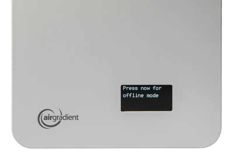

  1. Power on / power cycle the monitor if it was already on.
  2. Wait for the prompt During startup, the display will show the message: “Press now for offline mode”
Alt text
