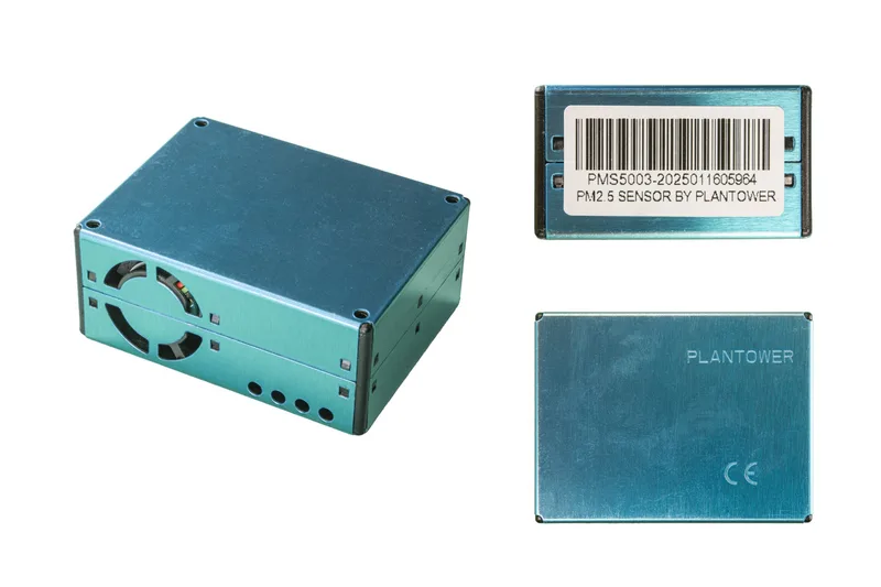

How to find your PM sensor’s batch number
To find the batch number, please look at the blue PM module. Each sensor has a sticker like the image above.
To avoid needing to open the monitor at a later date, please note down or take a photo of this number during assembly.
In the dashboard, you can then select the appropriate batch correction formula that matches your sensor’s serial number. For example, for the sensor in the image above, the correct batch correction formula would be:
