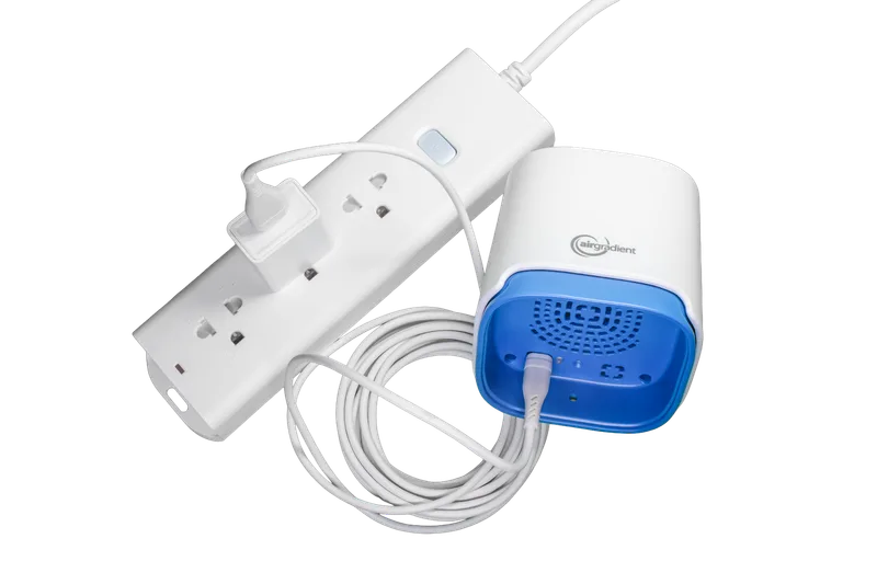

Use a standard 5V, 2A USB power supply (not included). Most phone chargers meet this requirement.
You will likely have one of these lying around your house from a smartphone or another device.
Alt text
  1. Connect the USB-C end of the included cable to the AirGradient Open Air
  2. Connect the USB-A end to the USB power supply
  3. Plug the power supply into an AC outlet
Alt text
