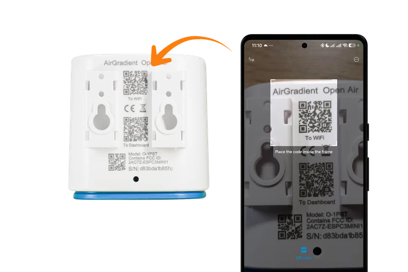

All pre-assembled AirGradient Open Air units include a printed QR code on the enclosure.
Alt text
Scanning it simply skips the step of manually searching for the hotspot and connects you directly to the device’s WiFi network:
airgradient-xxxxxxxxxxxx
Note: The device must be in WiFi connection mode when scanning the QR code. If it is not in WiFi connection mode, the QR code will not connect you to the device hotspot.
(Where xxxxxxxxxxxx is your device’s serial number. If you’re setting up a DIY kit, you may want to note down the Serial Number for dashboard onboarding later.)
DIY kit units do not have the QR code, but the setup process is identical – you just join the hotspot manually from your WiFi settings.

Option A: Scan the QR Code (pre-assembled units)
  • Scan the QR code on the back of the enclosure.
Alt text

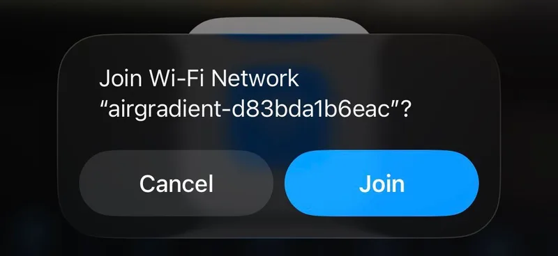

  • Your phone will prompt you to join the WiFi network:
Alt text
  • Tap Join.
(This skips the step of manually locating the hotspot.)

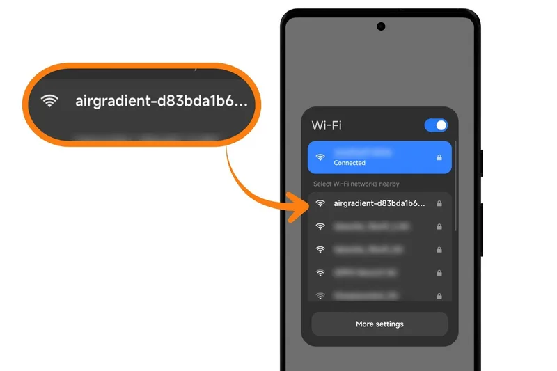

Option B: Join the Hotspot Manually (all units, including DIY kits)
Open your phone, tablet, or laptop WiFi settings.
  • Look for and select the network:
Alt text

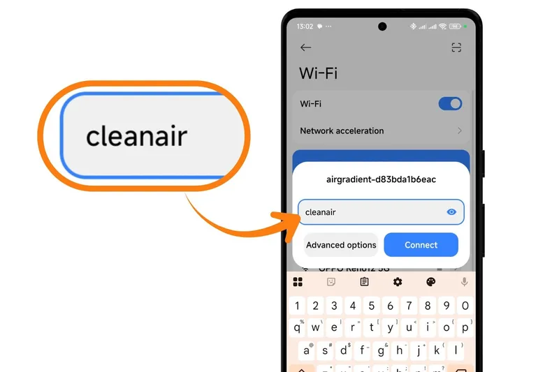

  • Enter the password:
cleanair
Alt text

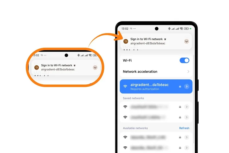

Android notes and troubleshoot
  • Android 11/12 may show Manage router → tap it.
  • Some versions require tapping “Tap here to sign in to network” to open the WiFi Manager.

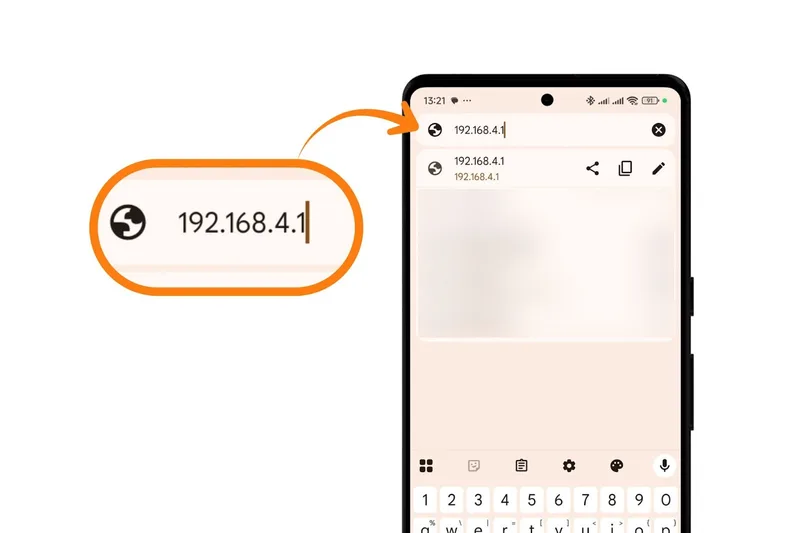

  • Open a browser.
  • Go to: 192.168.4.1 (Enter it in the address bar, not a search engine.)

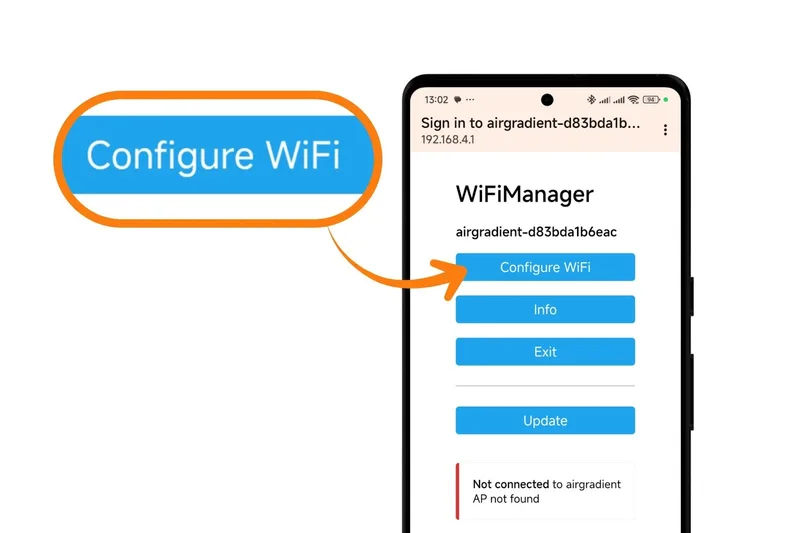

  • Tap Configure WiFi

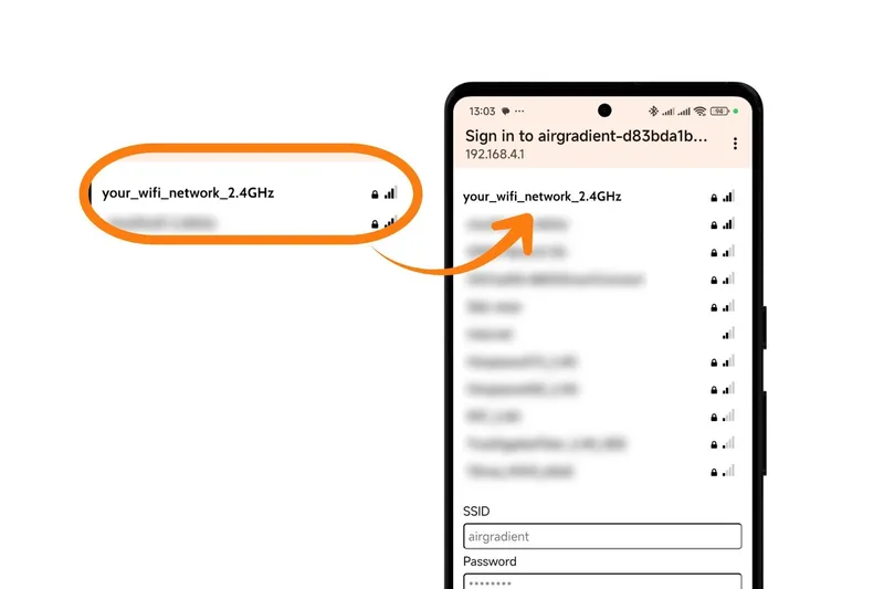

  • Select your WiFi network
Alt text
For hidden networks, enter the SSID manually.

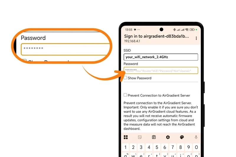

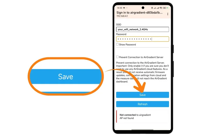

  • Enter your WiFi password
(Enter the password for your WiFi network. Do not enter ‘cleanair’ here—that password is only for connecting to the device hotspot.)
Alt text
  • “Prevent connection to AirGradient servers” is unchecked, if you want the devices to connect to the AirGradient dashboard and receive automatic firmware updates.
  • Tap Save
Alt text

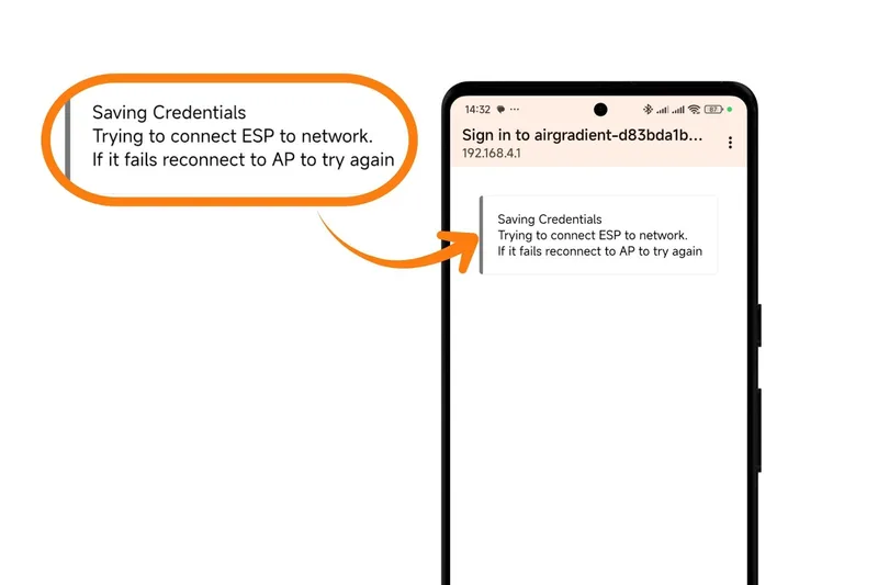

1.5 Credential Saving & Expected Behavior
You’ll see:
“saving credentials…”
Stay on this page. Do not disconnect.
Alt text
  • If the password is correct → the window closes automatically.
  • If incorrect → you are returned to the network list.
  • If the captive portal times out → the device reboots. Reconnect to the hotspot and start again.
  • If the window closes without showing “saving credentials…” → it still means success.
“No Internet Connection” warnings: Totally normal. Stay connected to the hotspot until the process completes.
