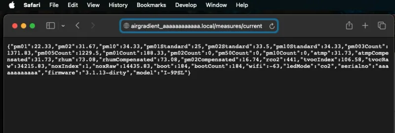

Get the latest measurements
Open a browser or make an HTTP request to:
http://airgradient_SERIAL_NUMBER.local/measures/current
Replace SERIAL_NUMBER with the serial number of your monitor. For example:
http://airgradient_aaaaaaaaaaaa.local/measures/current
Alt text
The monitor returns the latest measurements in JSON format.

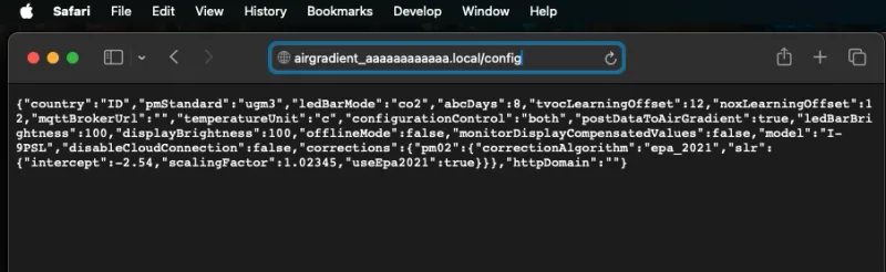

Get the monitor configuration
To retrieve the monitor's local configuration, use:
http://airgradient_SERIAL_NUMBER.local/config
For example:
http://airgradient_aaaaaaaaaaaa.local/config
Alt text
For additional Local API endpoints and implementation details, see the Local Server Documentation.
