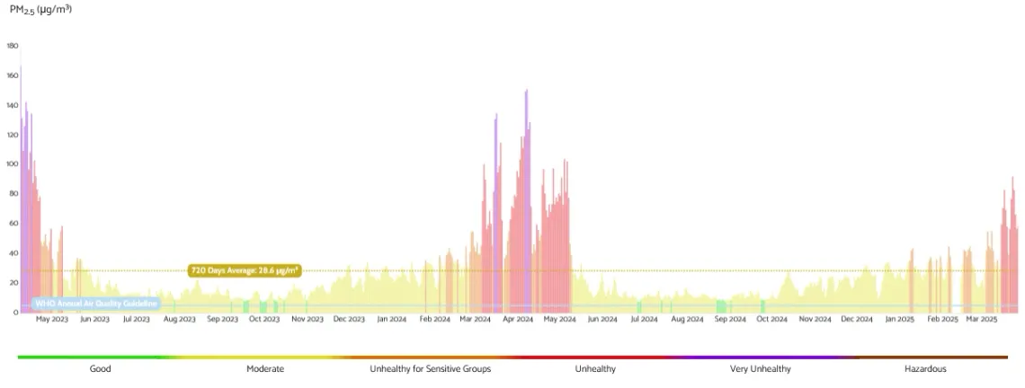

Time plots show how the air quality changes over time. It is useful to identify trends such as the continuous improvement or decline in air quality. It can also be used to identify patterns: maybe your neighbor enjoys a BBQ every Sunday, which might lead to poor air quality. See section 5 on how to identify trends and patterns.
1.1. Visualise Timeplots on the Dashboard

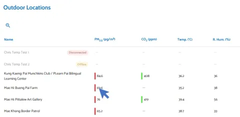

You can directly visualize timeplots of your air quality data on the dashboard. For example, a time plot will open when you click on the measured value of any monitor.
outdoor locations table
Example of a time plot visualised on the Dashboard:
adjust interval
Color code: High PM2.5 values indicate an increased health risk. This risk is visualized in the Dashboard time plots using a color code based on the Ambient Air Quality Standards of the U.S. Environmental Protection Agency (EPA) and the air quality guidelines of the World Health Organization:
color code
Additionally, you’ll see a horizontal line representing the target maximum concentration from the World Health Organization’s Air Quality Guidelines. Keep in mind that this WHO guideline refers to an annual average, while the Dashboard may display data over shorter time periods, such as daily values.

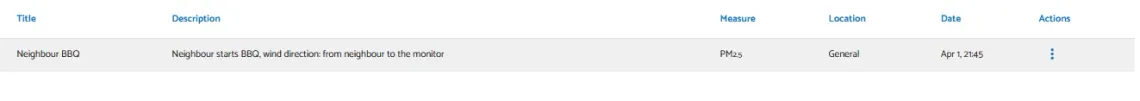

1.2. Adding notes to your Dashboard timeline
Sometimes, it is useful to save some information about events that might influence the readings of your sensor. For example, when a wildfire breaks out nearby, or your neighbour is having his Sunday BBQ.
Click on any point in the displayed time series to add a note. Then, a window will pop up where you can add the details of your event.
data to note
add note form
Once you have entered and saved the information, a note will appear on your timeline and in the “Notes” section, which you can reach via the hamburger menu on the left.
Note in Chart
Note in Chart
Notes Table
Notes Table

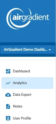

1.3. Visualise Timeplots via the Analytics function
Another way to display time plots in the Dashboard is to use the “Analytics” function.
menu item analytics
In this function, you can customise the time period that you want to have displayed. The same data as shown above ( example graph for a timeline plotted by the Dashboard) looks like this in the Analytics feature:

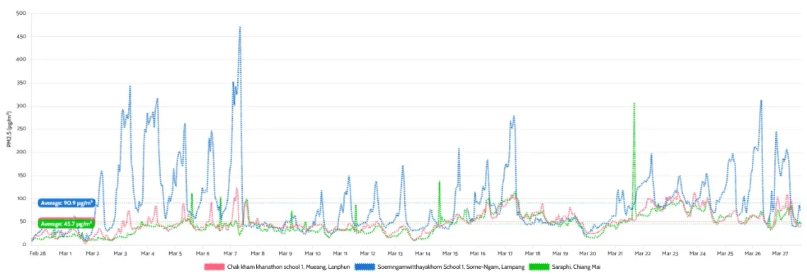

  1. Compare multiple monitors with each other.
    In the “Single parameter mode” of the Analytics function (default mode), you can compare the measurements of multiple monitors ( as long as the same pollutant is selected). This can, for instance, be useful in comparing air pollution across different locations.
line chart 3 monitors

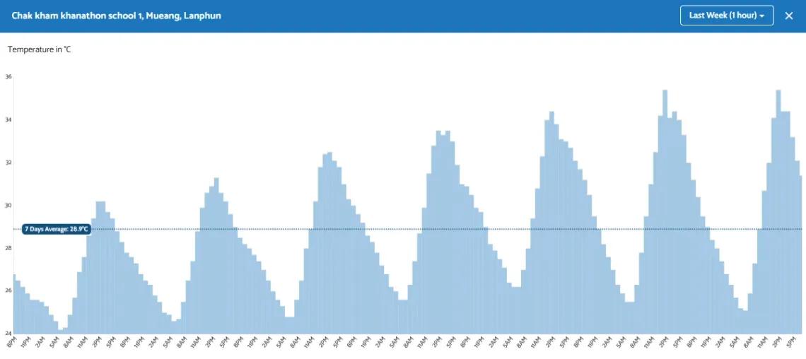

Daily trends in data can be very clearly seen in temperature readings. This is an example of the temperature variations in Chiang Mai, Thailand.
