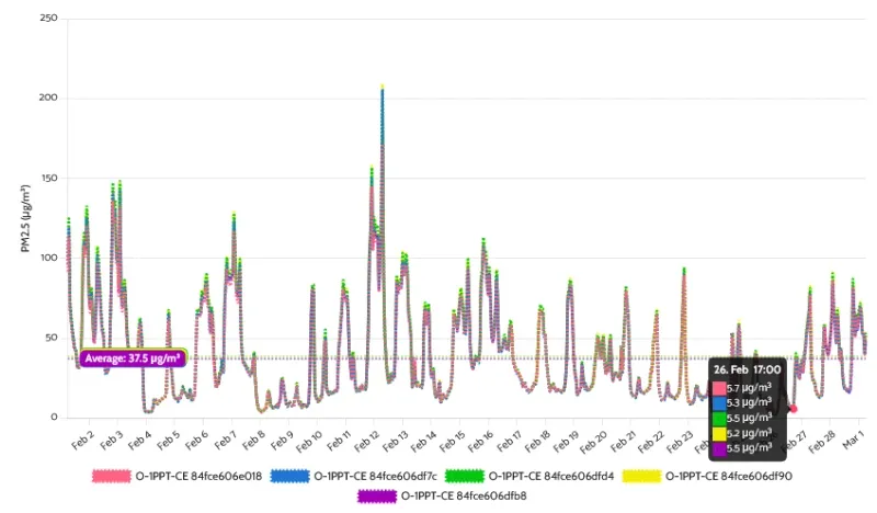

Case 1: All Sensors Show Consistent Measurements
If all sensor readings align closely, forming (or nearly forming) a single line, it means the measurements are consistent and reproducible. This confirms that all sensors have passed the reproducibility test, and you can proceed with calibration and deployment.
Healthy sensor network
Healthy sensor network: PM2.5 readings from five AirGradient monitors placed side by side (visualised with the Analysis Tool on the Dashboard). The data points align closely along a single line, showing the monitors are consistent and reliable.

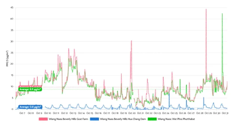

Case 3: Identifying a Faulty Sensor
If a monitor shows significantly different readings (e.g., a completely different pattern), it is likely faulty.
Faulty sensor readings
Faulty sensor readings: One sensor (blue) measures very low concentrations and doesn’t follow the general concentration trends at all. It needs to be repaired or replaced.

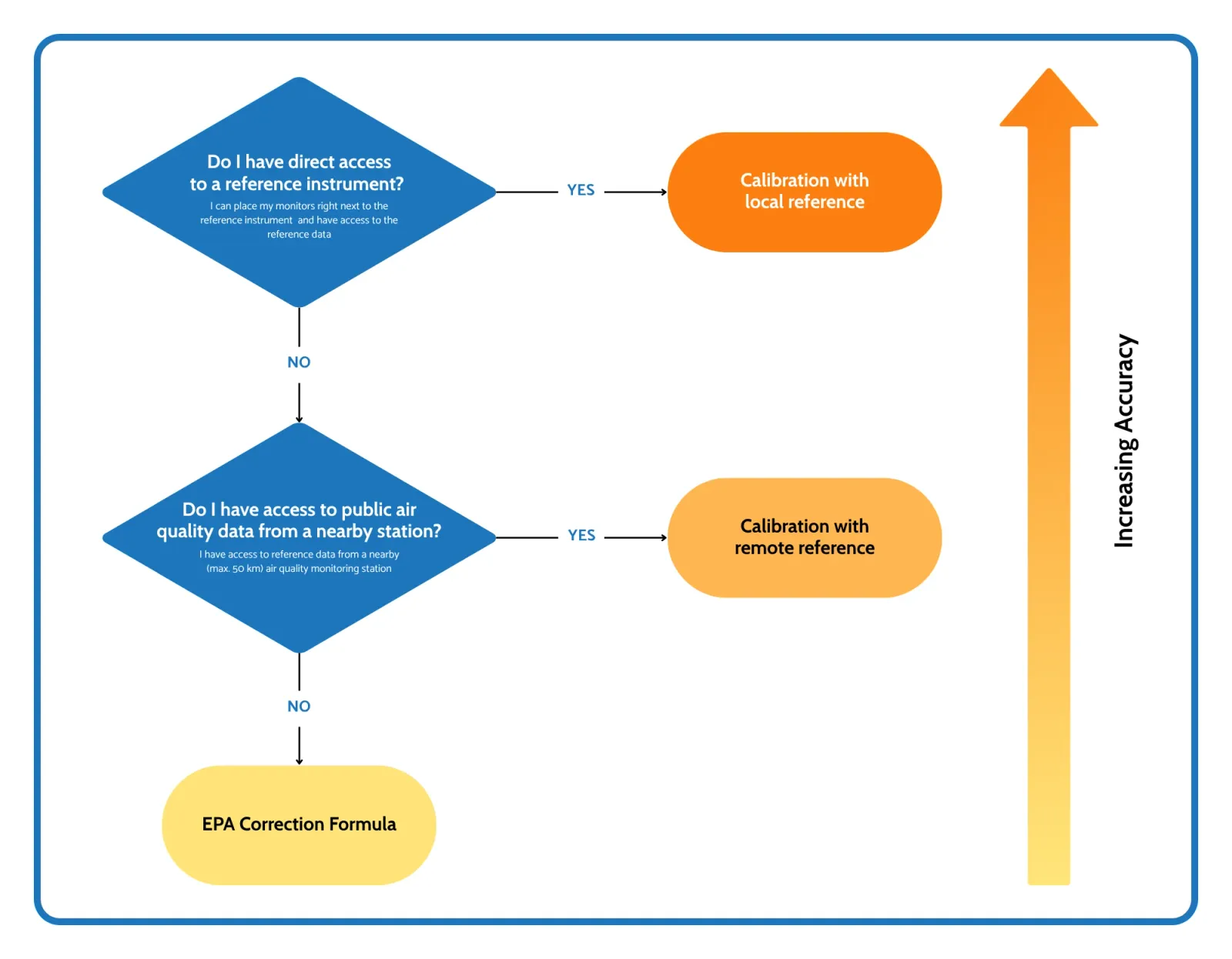

2. Selection of the calibration method
There are several approaches to sensor calibration, and the method used depends on how accurate you need your data to be and whether you have access to reference data. The diagram below helps you to decide which calibration method you should use.
Calibration method selection graph
Each of the methods will be explained in detail below but here you can find a brief summary of every method:
Calibration with local reference: The most accurate method is to co-locate your monitors with a local reference instrument in the same area (e.g. city) where the deployment takes place prior to deployment. However, not many people or communities have direct access to a high-level reference instrument and can place the low-cost monitors directly next to it.
Calibration with remote reference: When access to a physical reference monitor is limited, publicly available data from nearby air quality stations can be used to adjust sensor readings.
EPA Correction Formula: This calibration formula has been developed by the US Environmental Protection Agency. It can easily be applied and does not require a reference instrument. However, it does not account for the specific local conditions of your deployment.
These different calibration methods vary in accuracy, but all of them improve the overall sensor performance. Whether you have access to advanced monitoring equipment or are relying on alternative methods, proper calibration is important for high-quality air quality data. Without calibration, the absolute concentration readings may misrepresent actual pollutant levels. Therefore, we recommend applying at least one of the above mentioned methods.

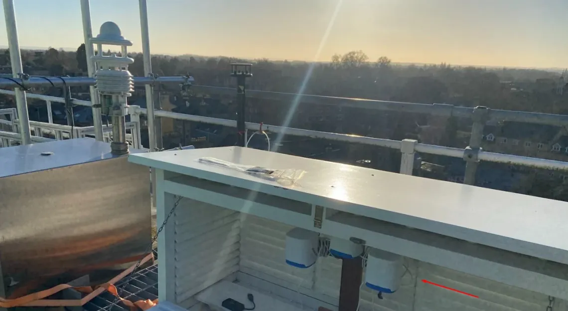

4.1. Considerations for the Co-location
For the best performance outcome, you should ensure that the reference instrument and sensor experience the same environmental conditions during co-location as they will in actual use (i.e. during your deployment). You can achieve this by following these points:
  • Position of the Sensor(s): Place the sensor close to the inlet of the reference instrument (within a few meters) to ensure both are exposed to identical air quality and environmental factors (e.g., sunlight, humidity, and wind).
  • Location of the Monitoring Station: Choose a reference site with environmental conditions similar to your deployment area.
  • Duration: Run the co-location long enough to capture the full range of expected conditions, ideally at least for 2 weeks.
  • Season: If possible, the calibration should take place in the same season as your deployment. Most commonly, it is performed directly before or after the deployment (or both).
Use the reference monitor only if you are confident the data is accurate. Sometimes, reference monitors can be inaccurate due to poor maintenance or a lack of calibration. Using an inaccurate monitor may lead to errors in calibration.
Co-location of three AirGradient monitors
Co-location of three AirGradient monitors (bottom right) with a reference station (left).

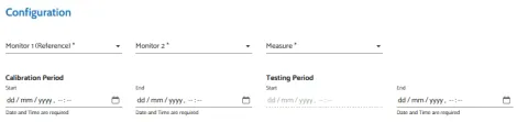

Select your data
First, specify which sensors you want to calibrate and select the data to use for calibration. To do this, complete the following interface:
Import the reference data into the platform
Monitor 1 (Reference)Select your reference instrument (needs to be connected to your Dashboard)
Monitor 2The monitor that you wish to calibrate
MeasureThe sensor type that you wish to calibrate (PM2.5, Temperature, Humidity)
Calibration periodStart and end date of the period you would like to use for the calibration, i.e. the time when the reference monitor and the low-cost monitor were placed together
Testing period (optional)You can use the testing period to validate whether your calibration method works as expected. It is an optional test, mainly intended for scientific applications. In this document we will focus on the calibration period only.

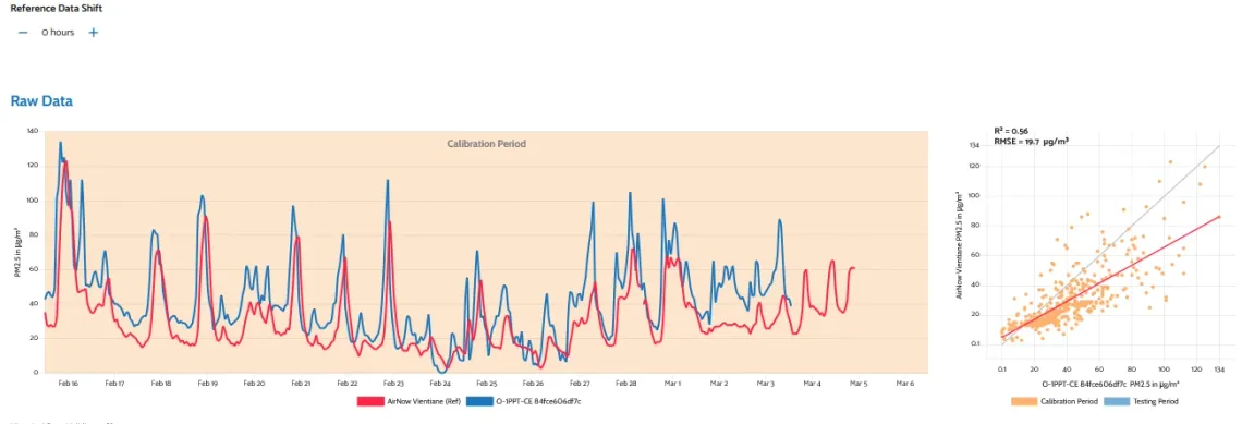

Visualisation of the data and time alignment
As soon as you have selected the data (Point 2) the system will visualise it:
Comparison of the raw monitor data with the reference measurements
Comparison of the raw monitor data with the reference measurements: Time plot (left) and scatter plot (right).
The interface displays raw sensor vs. reference data (left) and a scatterplot comparing them (right). The RMSE value in the scatterplot provides information about the average error of the low-cost sensor (find more information in this blog article). The R2 value shows how well the low-cost sensor tracks the concentration trends of the reference. The closer it is to 1, the better the correlation.

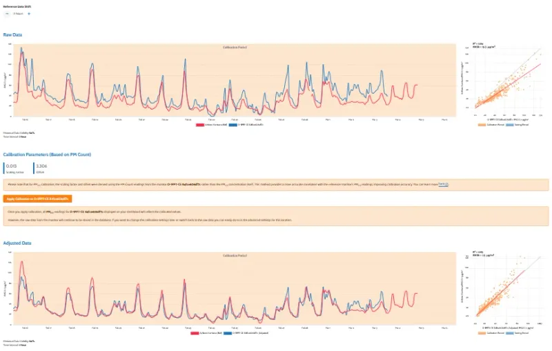

Automatic calibration
The tool automatically extracts the calibration parameters from the data set. These can be immediately applied to the low-cost sensor by pressing the orange button (Apply calibration to [name of sensor]). You can find the values of the parameters (scaling factor and offset) below the first graph of the tool.
Please note that for PM2.5 calibration, the scaling factor and offset were derived using the PM Count readings rather than the PM2.5 concentration itself. This method provides a more accurate correlation with the reference monitor's PM2.5 readings, improving calibration accuracy. You can learn more here.
Full view of the calibration tool
Full view of the calibration tool: Top: raw sensor vs. reference data. Middle: Automatically extracted calibration parameters and button to apply them to the sensor (orange). Bottom: calibrated sensor data vs. reference data.
Note for PM2.5 calibration: The calibration tool doesn’t factor in relative humidity (RH) effects or non-linear responses. However, in most cases, their impact on the data accuracy of the Plantower module is small. If you need the highest level of scientific accuracy, you have to fine-tune this calibration formula manually.

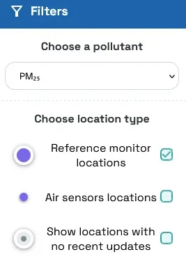

2. OpenAQ
OpenAQ is a nonprofit organization that collects and shares air quality data worldwide. You can explore their map (OpenAQ Map) to find reference monitoring stations near you—just ensure that only the “Reference monitor locations” filter is selected.
open aq filters
AirGradient partners with OpenAQ, contributing public outdoor data to the platform, making it also easy to integrate OpenAQ data into the AirGradient Dashboard in return.
