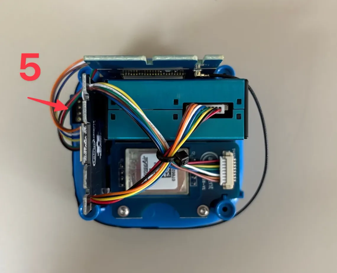

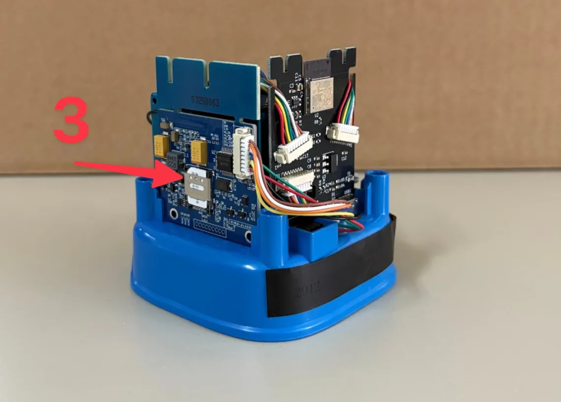

    6. Replacing Components
    Nearly every component in the AirGradient Open Air can be individually replaced. Here are the components:
  1. Mainboard (the main PCB (Printed Circuit Board) of the device with the USB port and connectors to the sensors).
  2. SenseAir S8 CO2 sensor (a sensor that sits next to the PMS5003T and is mounted on its own board. It is connected to the mainboard via a ribbon cable).
  3. Cellular card (the card that the SIM card slots into)
  4. PMS5003T particulate matter sensor (a large, blue box that is connected to the mainboard). This is the most likely component to need replacement as it has moving parts (a fan) inside.
  5. Cellular Antenna
  6. SGP40 VOC sensor (a small sensor that sits next to the USB port of the device).
Please refer to the images below for information on the placement of each component. Each of these can be purchased separately on the AirGradient store.

components 1 2
component 3
components 4 5
component 5
Any of these components can be removed and replaced if there is an issue. Replacement is as easy as unscrewing the faulty component and replacing the new part in the same way. However, there are a few considerations to keep in mind:
