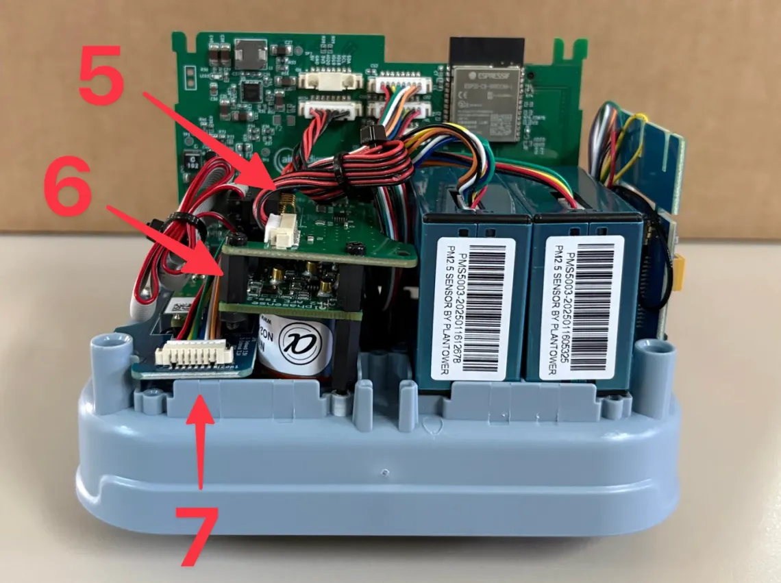

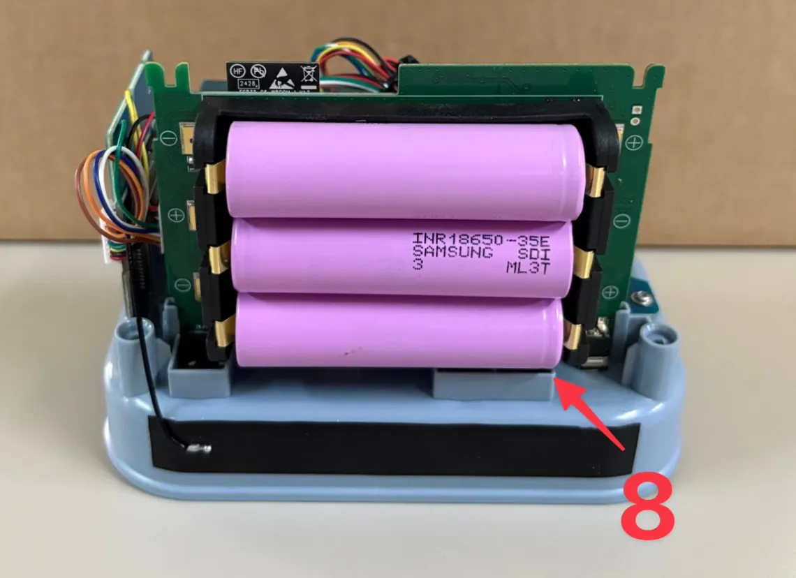

5. Replacing Components
Nearly every component in the AirGradient Open Air can be individually replaced. Here are the components:
  1. Mainboard (the main PCB of the device with the USB port and connectors to the sensors).
  2. PMS5003T particulate matter sensor (a large, blue box that is connected to the mainboard). This is the most likely component to need replacement as it has moving parts (a fan) inside.
  3. Cellular card (this contains the SIM card that can be changed)
  4. Cellular antenna
  5. Alphasense NO2 module (this is only found on the O-M-1PPSTON model, not the O-M-1PPST model)
  6. Alphasense O3 module (this is only found on the O-M-1PPSTON model, not the O-M-1PPST model)
  7. SenseAir S8 CO2 sensor (a sensor that sits next to the PMS5003T and is mounted on its own board. It is connected to the mainboard via a ribbon cable).
  8. Battery cells (18650 batteries)
  9. SGP40 VOC sensor
The O-M-1PPSTON-CE also houses an ozone and nitrogen dioxide sensor from Alphasense. Please note that these sensors need to be replaced every two years for the best performance.
Please refer to the images below for information on the placement of each component. Each of these can be purchased separately on the AirGradient store.

components 1 2
components 3 4
components 5 6 7
component 8

Any of these components can be removed and replaced if there is an issue. Replacement is as easy as unscrewing the faulty component and replacing the new part in the same way. However, there are a few considerations to keep in mind:
  • When replacing components (or cleaning them), ensure you have a clean area to do so. It’s very easy to lose small parts like screws, and having a clean desk top or other surface to work on will prevent you from losing important parts.
  • Ensure you work in a dry environment. If the components get wet or damp, they may cease to function.
  • Some components, like the ribbon cables (for the PM and CO2 sensor) and the SGP40 VOC sensor are easy to damage if too much force is applied. Please be gentle when replacing these parts.
  • After replacing a component, we recommend plugging the device in and checking that all sensors are functioning before deploying the device again.
