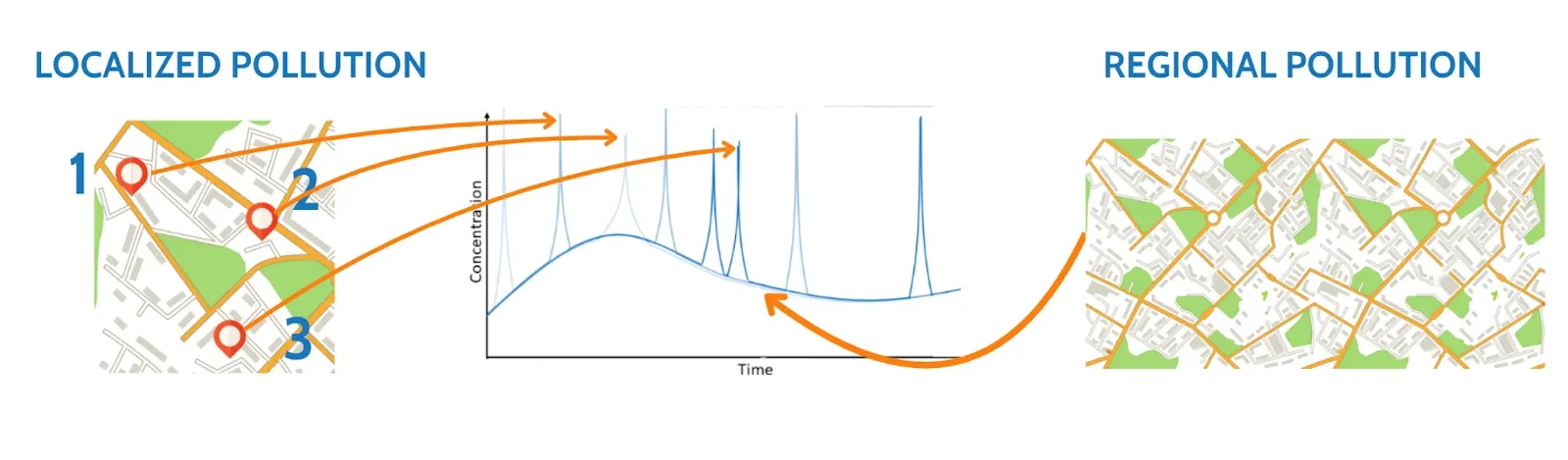

    As discussed in [Chapter P2 \- Defining Your Air Quality Project](/professional/cities/undp-toolkit/planning/defining-the-project), air pollution is composed of two main elements: regional background pollution, which remains relatively uniform across large areas, and local emissions from sources like vehicles, industrial facilities, or residential heating.
pollution map
A well-distributed network of AQ monitors provides a big advantage: since all monitors in the area are subject to the same background pollution levels, their readings can be compared and cross-validated. This network effect can be used to detect anomalies and calibrate sensors, leading to a better measurement accuracy.

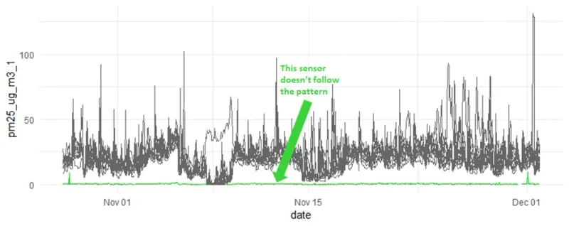

In a properly functioning network, sensor readings should follow a consistent pattern. This consistency allows us to spot any unusual readings that could indicate a problem. For example, an analysis of **PM2.5 readings from 16 AirGradient monitors in Pai, Thailand,** showed that 15 sensors followed the same baseline (i.e. the regional air pollution levels), while one sensor (green line) consistently reported significantly lower values despite being in the same network. This discrepancy suggests a potential fault that requires investigation.
faulty sensor in graph
By regularly comparing readings across the network, faulty sensors can be quickly detected and addressed, ensuring accurate and reliable air quality data.
