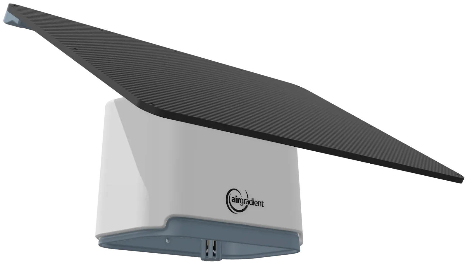

Open Air Max (O-M-1PPSTON-CE)

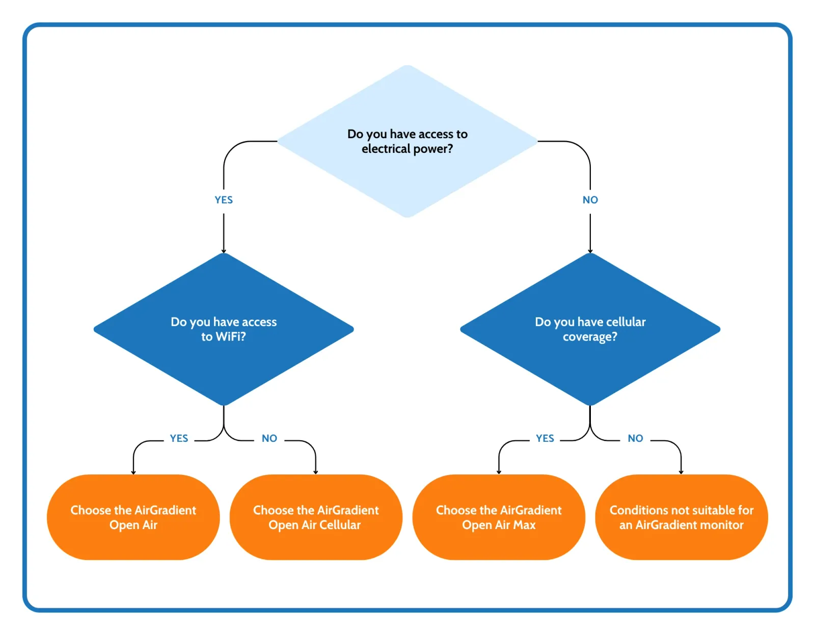

Decision Map
Figure 2: Decision Map

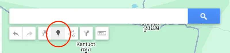

  1. Create a New Map: Go to Google My Maps and create a new map for your monitoring area
  2. Mark Potential Sites: Use the "Add marker" tool to mark potential monitor locations on the map.

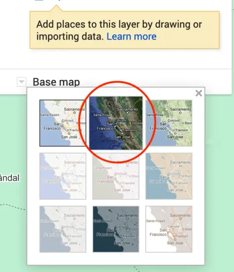

  1. Utilize Satellite Imagery: Switch to satellite view to examine the surroundings of each site. Use satellite imagery to identify potential pollution sources, wind obstructions, and general site characteristics.

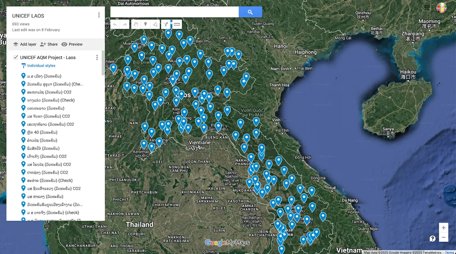

Map to visualize sites in Lao PDR.
Example of using My Map to visualize sites for a Project in Lao PDR.
