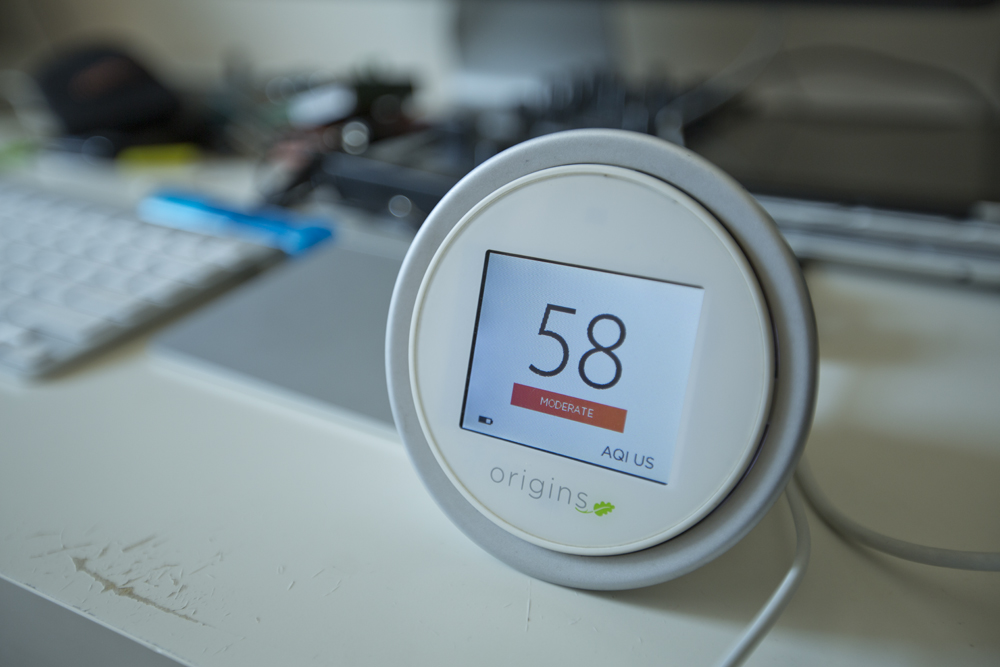

PM 2.5 Meter
Particulate Matter (PM) 2.5 refers to particles or compounds which spans less than 2.5 micrometers in diameter. They are fine particles that are commonly produced from factories, vehicle exhaust, burning of crops or volcanic eruptions. Long-term exposure to high concentrations of these particles can put people at risk of developing respiratory illnesses, inflammation, trigger asthma and can even lead to lung cancer.

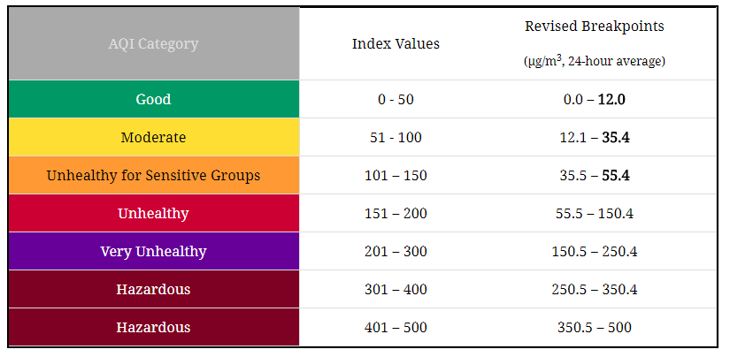

There are many types of PM 2.5 meters in the market, with some of them capable of measuring other types of pollutants as well. PM 2.5 is most commonly measured in units of µg/m3 (micrograms per meter cubed), or through AQI measurements (meter below).
exp a

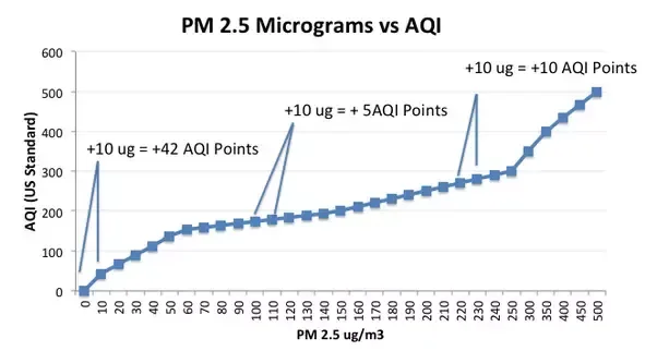

Depending on the meter you purchase, it may display either one of the units of measurement. However, keep in mind that the two measurements are not directly proportional to each other as measurements in µg/m3 are representative of the actual amount of PM in the area whereas AQI measurements are subjective to the air quality standards that have been internationally agreed upon for your particular region. This difference in proportionality is represented in the following graph:
exp b
Having a corresponding AQI level alongside PM2.5 measurements can help students measure the precise amount of PM2.5 in a certain area and use them to determine the quality of the air. Students could measure air quality in different areas, comparing the results obtained and discuss the probable causes and sources of PM from the location. It is also a great way to measure quantitative values that are useful for writing scientific reports while reinforcing the numbers with a qualitative interpretation of the air quality.

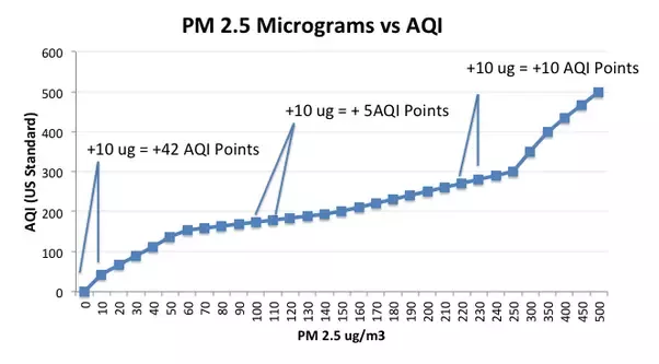

You could perform these measurements with your students for a variety of experiments. For example, by comparing the PM measurements from outdoor areas to indoors, students would become aware of the differences in air quality and discuss the possible outdoor/indoor pollutants that may cause one to have higher PM levels than the other. Another great experiment would be to compare the PM levels of rooms that use purifiers and those that do not. This would demonstrate the effectiveness of air purifiers to students and how they are beneficial to maintaining their general wellbeing.
The following graph compares the different levels of PM 2.5 and US AQI PM 2.5 measurements provided by sarta.innovations2019.org:

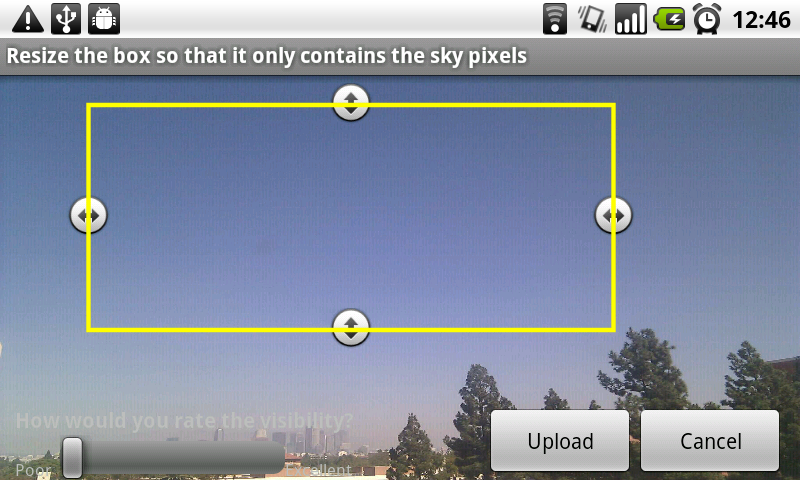

The color of the sky is a reliable qualitative method to measure air quality. The color can change due to airborne particles that reflect and refract light. For example, a blue sky would indicate little to no air pollution whereas bright red ones are a result of heavy pollution.
The University of Southern California developed an algorithm through its mobile sensing project to measure the air quality by analyzing pictures of the sky taken from the Android app that they created. The pictures that would be taken would take into account the user’s location, orientation, time taken and transfer the data collected into their server. It would calibrate the image and compare it with their own model of the sky.
exp d
Although their app isn’t officially listed in the Play Store, all you have to do is click this link from your Android mobile device and click ‘Download Android App’ on from their website. If your phone is preventing the download, click here to find out more about installing APK files on your phone.

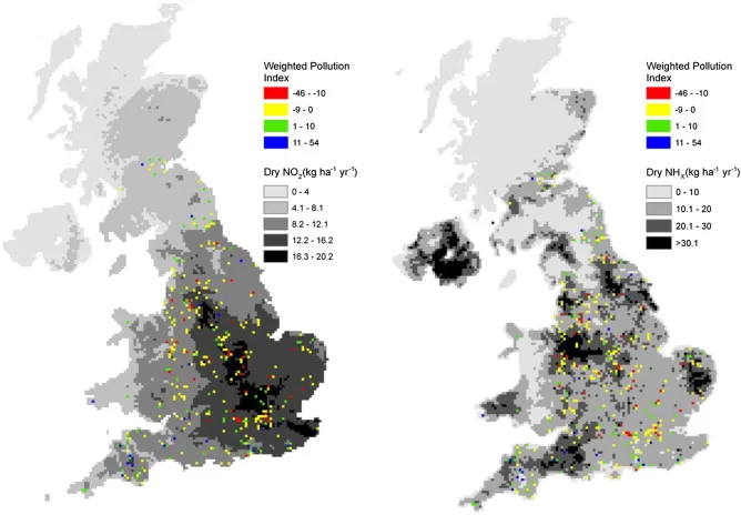

Lichen is an effective bio-indicator of sulfur and nitrogen pollutants. If lichen is a naturally occurring substance in your area, it will not be present if they are in the air and there would be green algae in its place. Many more species can act as a bioindicator for particular pollutants depending on vegetation that are sensitive or tolerant to them. A massive study was conducted using lichens to measure the air quality throughout the UK by the OPAL Air Survey.
The study conducted modeled the relationship between lichens as a bioindicator, nitrogenous pollutants, and their climate. Furthermore, the data was easily collected by everyday citizens throughout the UK and can be performed as school experiments as well. The map of the UK on the left demonstrated the amount of nitrogen dioxide (NO2) around the country while the one on the right referred to NHx radicals such as ammonia (NH3) and ammonium (NH4), which can cause ammonia pollution. The following image is their result:
exp h
The UK Centre for Ecology & Hydrology developed the Lichen Web-App, which provides guidelines on how to identify what type of lichen is suitable for testing, how to perform chemical tests on them and a comprehensive list of different species that are sensitive or tolerant towards nitrogen. It also enables you to track and record any trunks and branches that have lichens on them. They also created a measurement system called Nitrogen Air Quality Index (NAQI) to accurately associate the different levels of nitrogen to indicate their corresponding level of air quality.
Students could emulate this study on a much smaller scale and explore their environment for lichen or other similar species. This would also make them aware of how vegetation is often sensitive towards pollution.

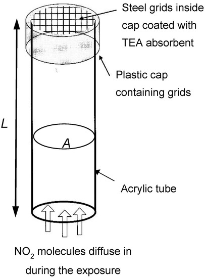

Palmes Passive Diffusion Tubes
Nitrogen can exist in many forms, one of them being nitrogen dioxide (NO2). Nitrogen dioxide is a gaseous pollutant produced from the burning of fossil fuels such as those in power plants and vehicle exhausts. It undergoes a process in which neutral nitrogen (N2) and oxygen (O2) particles react in high temperatures to produce nitrous oxides (NOx) including NO2, all of which can inflict respiratory conditions such as inflammation, coughing, irritations, etc. This is clearly demonstrated from the image on the right which was performed in an experiment from the University of Edinburgh.
exp i
Passive diffusion tubes are an effective long-term method to measure nitrogen dioxide. These small plastic tubes contain a mesh disc made of steel covered with a chemical called triethanolamine (TEA). If nitrogen dioxide is present and passes through the mesh, it would react with TEA and change the color and chemical composition. Diffusion tubes can measure the change in nitrogen dioxide levels over many months inside classrooms or outside your school based on how much TEA is left in the tube.

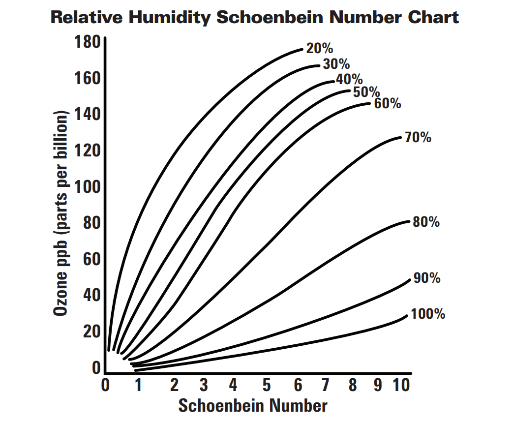

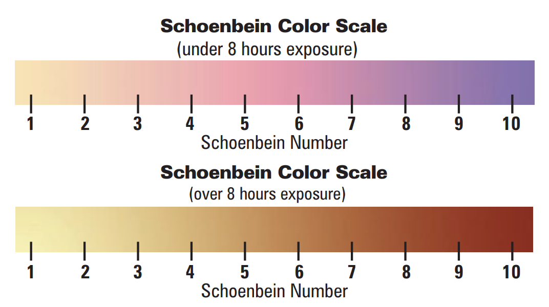

  2. For a more advanced chemical experiment, you could also perform the Schoenbein experiment. Students would require cornstarch and potassium iodide to make indicator strips that would react with ozone if present in the air, evidently turning blue or purple. According to the resulting Schoenbein number from the color scale below, we can determine the amount of ozone present in parts per billion (ppb) as seen from the following from the graph.
exp j
exp k
It is important to perform this experiment in days with low humidity (the lines from the graph represent how the Schoenbein numbers vary based on the different percentages of humidity in the air). Under these circumstances, ozone would be more likely to break apart into atmospheric oxygen. This experiment also yields the best results in the ozone season, which occurs during heated temperatures throughout the summer and in areas with high vehicle activity.
While this method is relatively safe, it is advised to perform this under the supervision of Chemistry teachers who can provide them with the chemicals and laboratory equipment needed.
