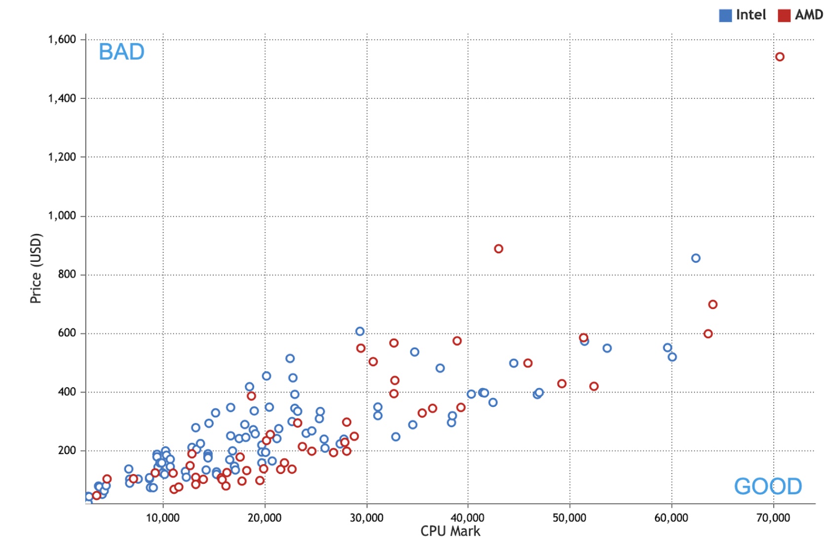

Learn MoreTypically, a higher product price should correlate with better quality, features and/or performance. Take for example computer CPUs: The higher the cost of the CPU, the better the performance. The graph below chart illustrates that very well:

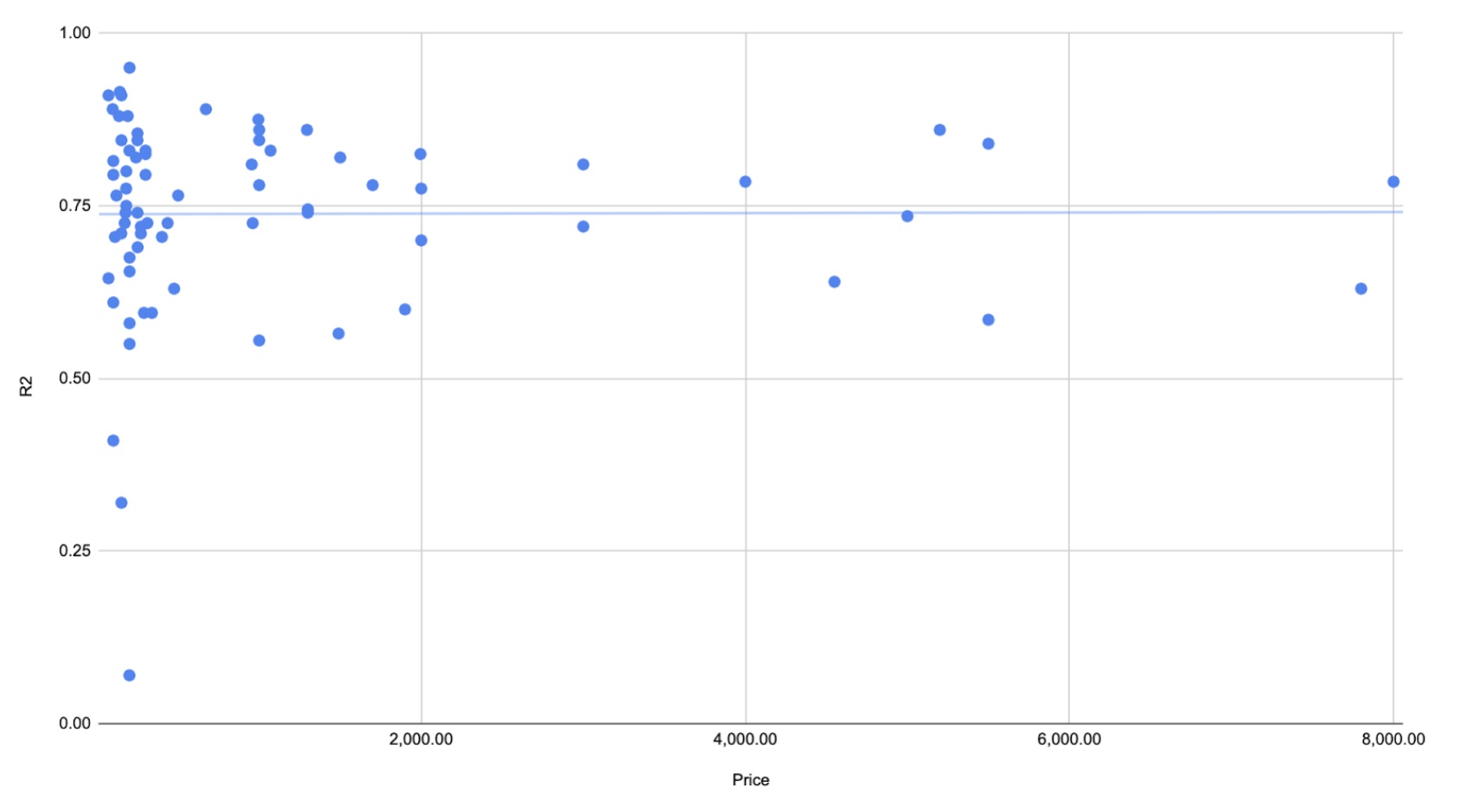

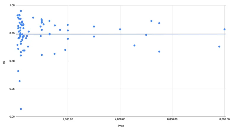

South Coast AQMD, does independent tests of air quality monitors and most of the well-known monitors went through this testing. So this is an excellent data source that we can use for our analysis. I downloaded the data as of April 12, 2023 and looked at the correlation between price and accuracy. As an indicator for the accuracy, the agreement between the sensors and a standard reference instrument was determined. To quantify this agreement, South Coast AQMD determined the R2 value which measures the linear relationship between the sensor and their reference instrument. An R2 approaching the value of 1 reflects a near perfect correlation, whereas a value of 0 indicates a complete lack of correlation.
When we plot the accuracy (R2) against the price of all the monitors tested, we can see the following:
It looks quite different from the charts about CPU performance, doesn't it? The price does not seem to affect the accuracy of the monitor which can also be seen by the flat trend line.

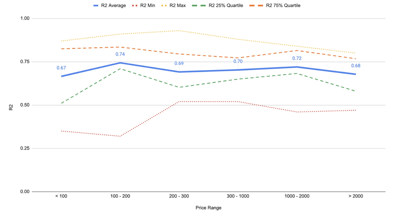

In the next figure, I separated the monitors into different price ranges and show the average, minimum, maximum as well as 25% and 75% quartile of R2. Here we can see that monitors in the price range of USD 100 - 200 seem to offer the best accuracy and that the most expensive monitors accuracy is pretty much the same as of the cheapest monitors.
So, a monitor that costs USD 2000 delivers the same accuracy as a monitor for USD 200 (for PM2.5 measurements).
