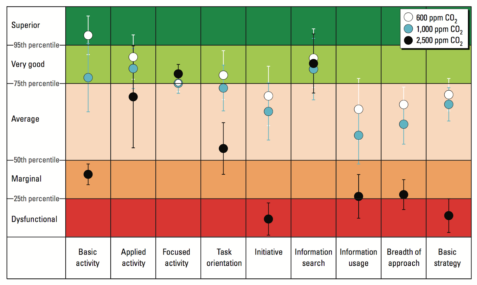

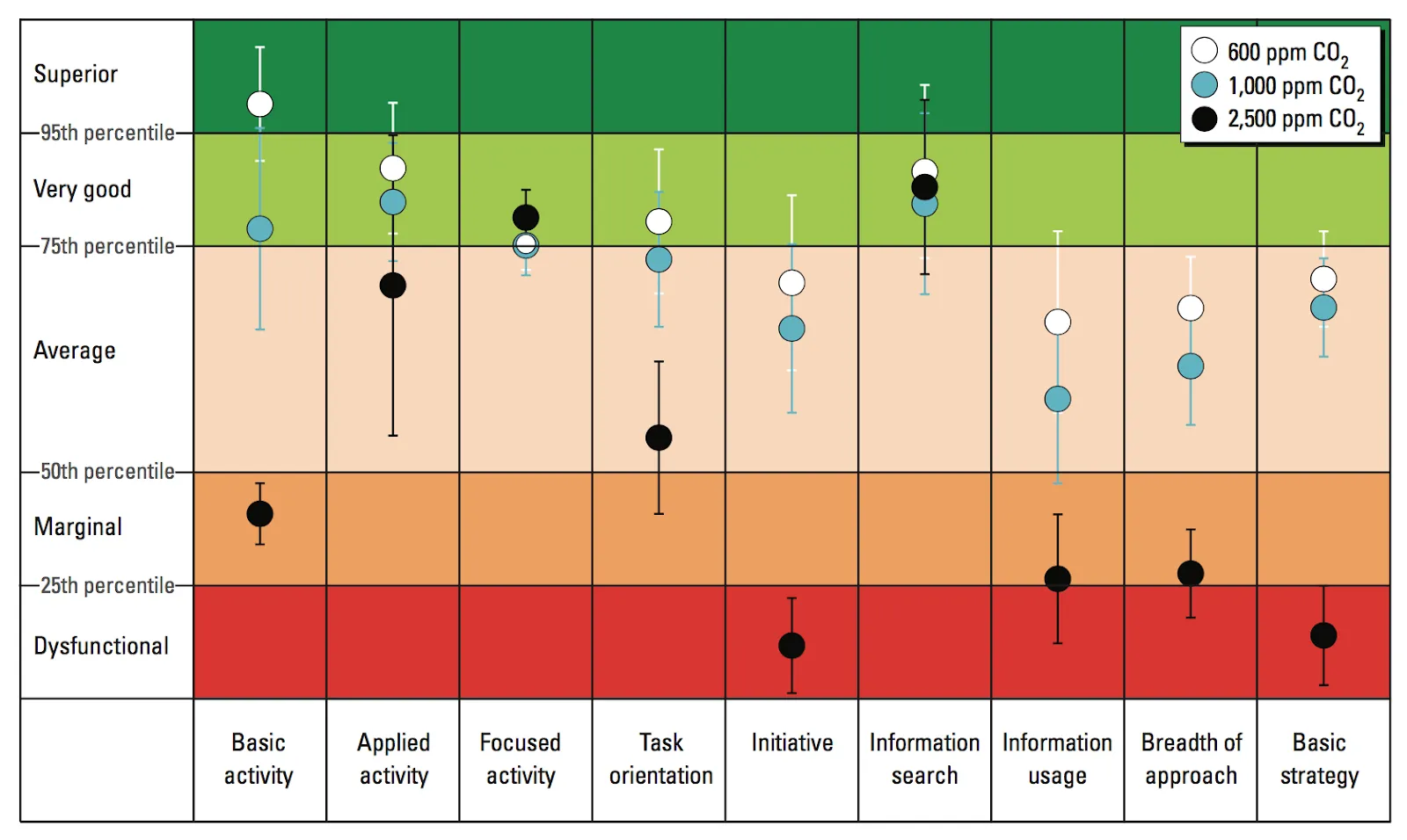

The following chart is derived from a study that exemplifies how the performance of different decision-making tasks are affected by three levels of CO2 (600, 1000, and 2500 ppm).
co2 a mmtadui7 ed1vuuck

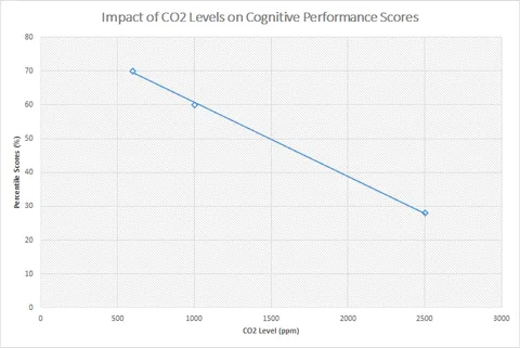

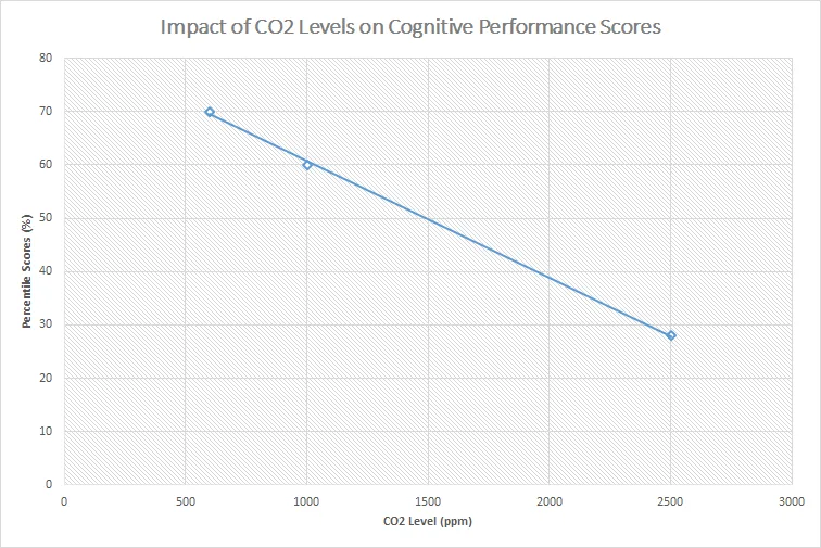

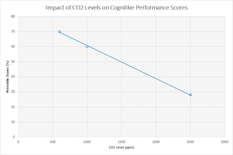

The chart indicates that activities performed in 600 and 1000 ppm of CO2 range from good performance to average (as they reside in the green to light orange regions). However, those performed at 2500 ppm performed significantly worse (most results residing in the orange and red regions). For example, we can extrapolate the data from the “Information Usage” section (one of the performance tasks determining the student’s ability to effectively utilize given information) into a linear scale. From this we can visualize how increasing levels of CO2 decreases the student’s performance in “Information Usage”:

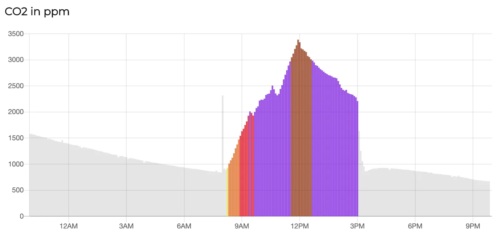

While most classrooms had acceptable levels of CO2, one particular classroom showed very high CO2 levels.
The graph below from this classroom shows the development of CO2 throughout the school day:
co2 c mmtadurz 133a294i
Before going into the reasons for the high CO2 values, lets first analyze the data:
  • When the school opens at 8 am, CO2 levels began to rise from the initial amount of 1000ppm (and not the typical outside CO2 of around 400ppm).
  • By 10 am, levels skyrocket to over 2000ppm.
  • By 12 pm, the amount of CO2 peaks beyond 3000ppm.
  • After 12 pm, CO2 levels drop by a normal rate. This is perhaps due to students going out of the room for their lunch break, allowing fresh air to circulate.
  • By 3 pm, CO2 levels drop below 1000ppm as students go home

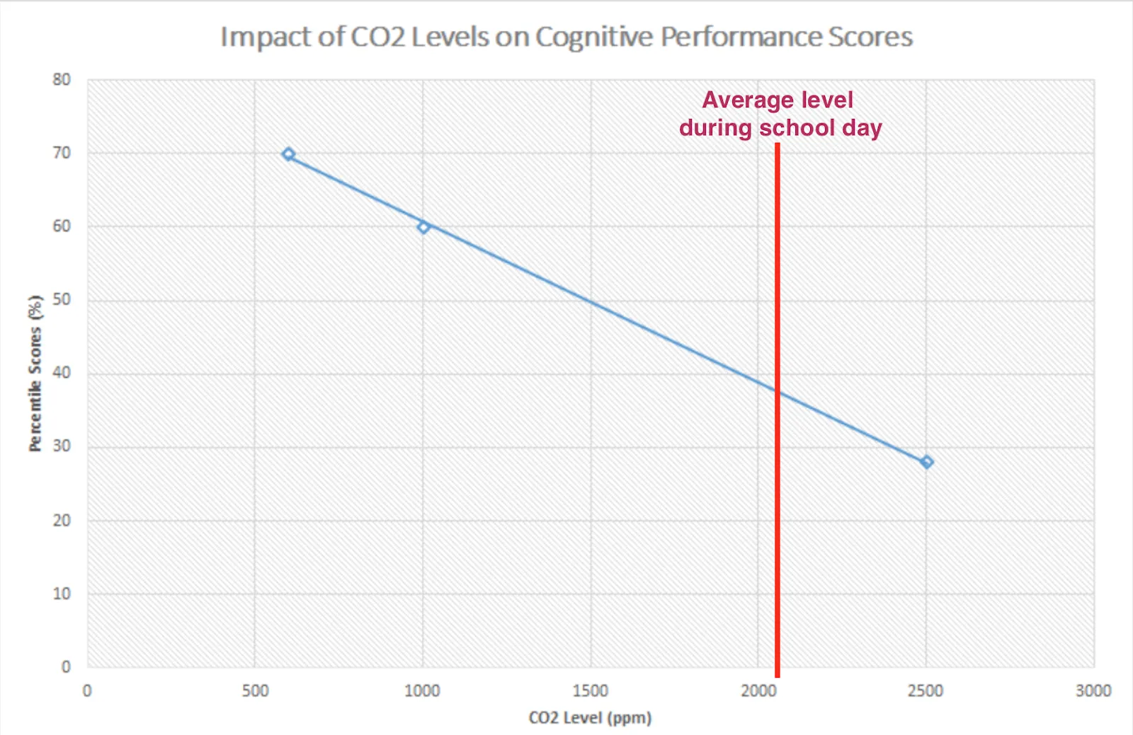

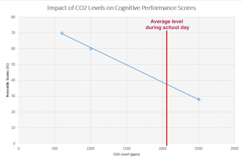

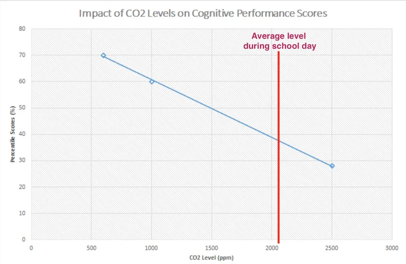

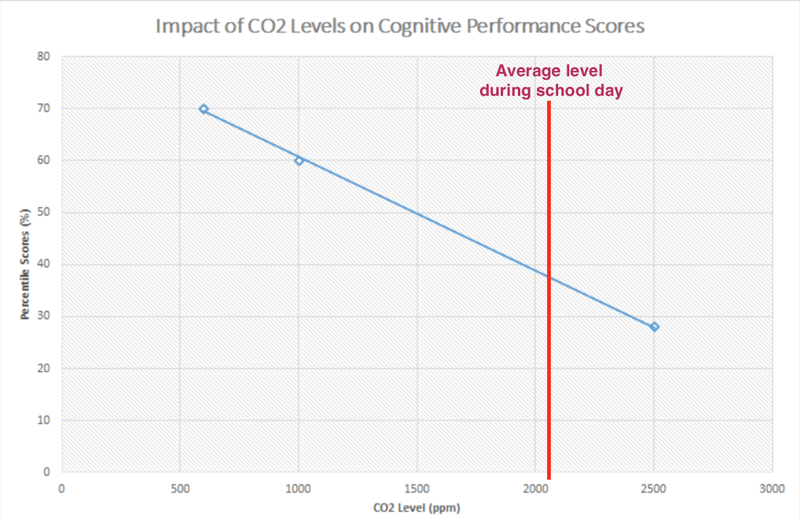

The average during the school day in this particular classroom is approximately 2080 ppm CO2. From the information we gathered from the studies above, we can expect the student’s cognitive performance to become severely limited on a daily basis. If we assume a linear development and look for instance on “Information Utilization” from the study above, the average individual would function at approximately 28% of our full cognitive performance based on the average CO2 measured during that school day.
