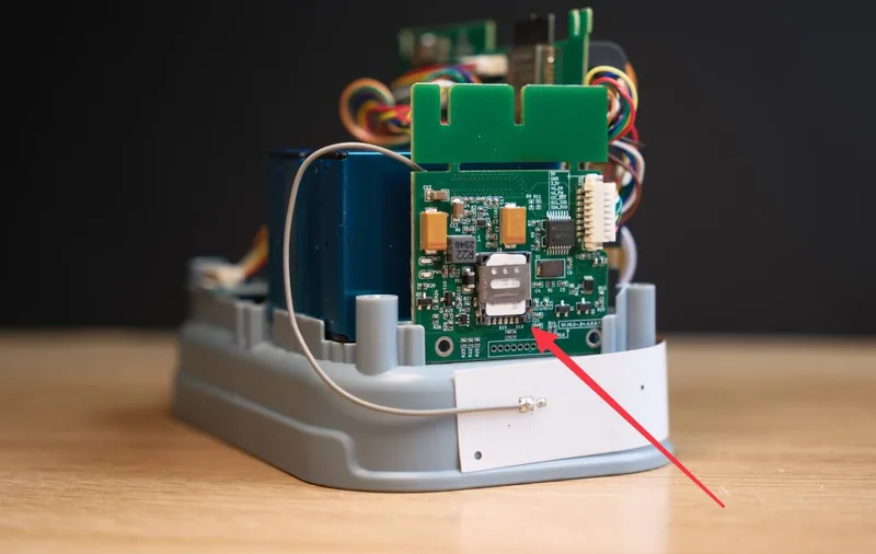

Using Your Own SIM Card
Alt text
To replace the SIM, simply push the metal SIM bracket and slide it down to unlock the bracket.
Remove the old SIM card, slide in your own new SIM card, push the bracket in place and slide up to lock the SIM bracket.
